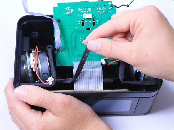

  13. Insignia NS-CLLT01 LCD Screen Replacement, LCD Screen: crwdns2935265:013crwdnd2935265:01crwdnd2935265:02crwdne2935265:0 Insignia NS-CLLT01 LCD Screen Replacement, LCD Screen: crwdns2935265:013crwdnd2935265:02crwdnd2935265:02crwdne2935265:0
    • Lift the adhesive strip that holds down the grey ribbon cable which attaches to the circuit board and the LCD screen.

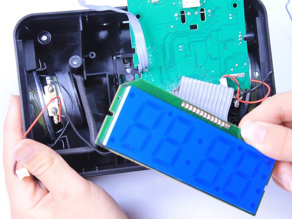

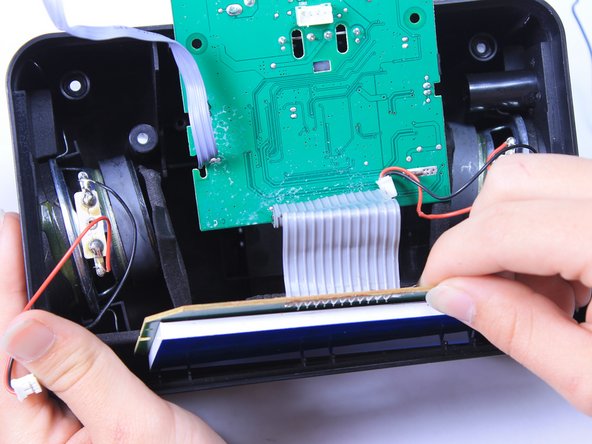

  14. Insignia NS-CLLT01 LCD Screen Replacement: crwdns2935265:014crwdnd2935265:01crwdnd2935265:03crwdne2935265:0 Insignia NS-CLLT01 LCD Screen Replacement: crwdns2935265:014crwdnd2935265:02crwdnd2935265:03crwdne2935265:0 Insignia NS-CLLT01 LCD Screen Replacement: crwdns2935265:014crwdnd2935265:03crwdnd2935265:03crwdne2935265:0
    • Remove the screen by pushing it toward the middle of the clock and pulling it up out of the clock.

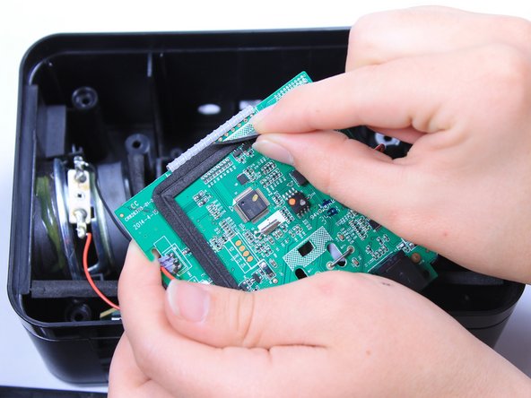

  15. Insignia NS-CLLT01 LCD Screen Replacement: crwdns2935265:015crwdnd2935265:01crwdnd2935265:02crwdne2935265:0 Insignia NS-CLLT01 LCD Screen Replacement: crwdns2935265:015crwdnd2935265:02crwdnd2935265:02crwdne2935265:0
    • Lift the adhesive strip that covers the connections between the grey ribbon cable and the circuit board by peeling it off of the circuit board.
