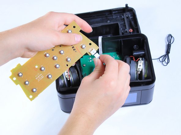

  7. Insignia NS-CLLT01 Button Replacement: crwdns2935265:07crwdnd2935265:01crwdnd2935265:01crwdne2935265:0
    • Lift the circuit board from the device.
  8. Insignia NS-CLLT01 Button Replacement: crwdns2935265:08crwdnd2935265:01crwdnd2935265:02crwdne2935265:0 Insignia NS-CLLT01 Button Replacement: crwdns2935265:08crwdnd2935265:02crwdnd2935265:02crwdne2935265:0
    • Detach the circuit board from the rest of the clock by gripping the sides of the white ribbon cable connector on the left-hand side of the board and pulling it straight off. You may need to use tweezers to grip the connector.

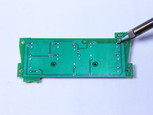

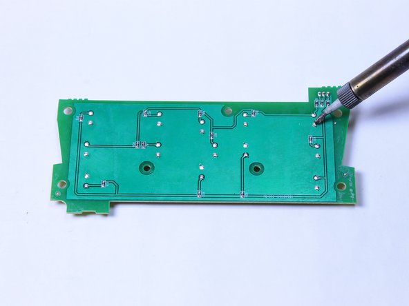

  9. Insignia NS-CLLT01 Button Replacement: crwdns2935265:09crwdnd2935265:01crwdnd2935265:03crwdne2935265:0 Insignia NS-CLLT01 Button Replacement: crwdns2935265:09crwdnd2935265:02crwdnd2935265:03crwdne2935265:0 Insignia NS-CLLT01 Button Replacement: crwdns2935265:09crwdnd2935265:03crwdnd2935265:03crwdne2935265:0
    • Use this soldering guide to remove and replace any buttons that were not working.
    • The buttons will be labeled on the top of the circuit board, and you will be working with the corresponding connections on the back.
