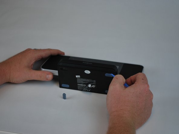

    • Set the clock radio on the work space so the bottom of the device is showing.
  2. Insignia NS-CLIP02 Motherboard Replacement: crwdns2935265:02crwdnd2935265:01crwdnd2935265:02crwdne2935265:0 Insignia NS-CLIP02 Motherboard Replacement: crwdns2935265:02crwdnd2935265:02crwdnd2935265:02crwdne2935265:0
    • Use a metal spudger to peel back the adhesive sticker on the bottom of the clock.
    • You should see a single screw beneath the sticker.
  3. Insignia NS-CLIP02 Motherboard Replacement: crwdns2935265:03crwdnd2935265:01crwdnd2935265:02crwdne2935265:0 Insignia NS-CLIP02 Motherboard Replacement: crwdns2935265:03crwdnd2935265:02crwdnd2935265:02crwdne2935265:0
    • Using a plastic opening tool, peel off the adhesive gel stoppers.
  4. Insignia NS-CLIP02 Motherboard Replacement: crwdns2935265:04crwdnd2935265:01crwdnd2935265:01crwdne2935265:0
    • Use a Phillips screwdriver to remove the six 11 mm screws on the bottom of the device.

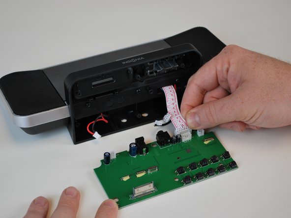

  5. Insignia NS-CLIP02 Motherboard Replacement: crwdns2935265:05crwdnd2935265:01crwdnd2935265:01crwdne2935265:0
    • Remove the bottom cover from the device to reveal the motherboard.
  6. Insignia NS-CLIP02 Motherboard Replacement: crwdns2935265:06crwdnd2935265:01crwdnd2935265:01crwdne2935265:0
    • Use a Phillips screwdriver to remove the 9.5 mm screw located near the center of the motherboard.
  7. Insignia NS-CLIP02 Motherboard Replacement: crwdns2935265:07crwdnd2935265:01crwdnd2935265:01crwdne2935265:0
    • Lift the motherboard away from the device.

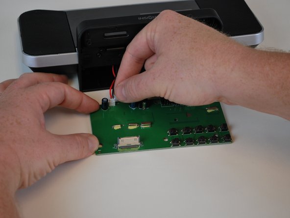

  8. Insignia NS-CLIP02 Motherboard Replacement: crwdns2935265:08crwdnd2935265:01crwdnd2935265:03crwdne2935265:0 Insignia NS-CLIP02 Motherboard Replacement: crwdns2935265:08crwdnd2935265:02crwdnd2935265:03crwdne2935265:0 Insignia NS-CLIP02 Motherboard Replacement: crwdns2935265:08crwdnd2935265:03crwdnd2935265:03crwdne2935265:0
    • Disconnect the four cables connecting the motherboard to the device.
