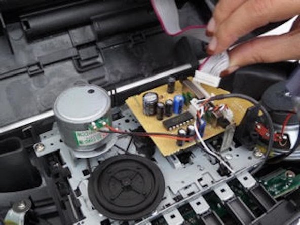

  6. Insignia NS-BCDCAS1 Tape Cassette Player Replacement, Tape Cassette Player: crwdns2935265:06crwdnd2935265:01crwdnd2935265:01crwdne2935265:0
    • Face the bottom of the opened boombox, and detach the front panel from the back in the following order:
  7. Insignia NS-BCDCAS1 Tape Cassette Player Replacement: crwdns2935265:07crwdnd2935265:01crwdnd2935265:03crwdne2935265:0 Insignia NS-BCDCAS1 Tape Cassette Player Replacement: crwdns2935265:07crwdnd2935265:02crwdnd2935265:03crwdne2935265:0 Insignia NS-BCDCAS1 Tape Cassette Player Replacement: crwdns2935265:07crwdnd2935265:03crwdnd2935265:03crwdne2935265:0
    • Unplug the 4 wires (1 red, 2 black, 1 white) from the yellow motherboard on the front panel, by pulling upwards.
    • Pull the black tape attached to the white plug on the yellow motherboard by tugging upwards.
    • Detach the thicker, white and pink cord on the smaller yellow plate on the front panel by pulling away.

  10. Insignia NS-BCDCAS1 Tape Cassette Player Replacement: crwdns2935265:010crwdnd2935265:01crwdnd2935265:01crwdne2935265:0
    • On the back of the unit to the right of the motherboard and between the motor and black circle, there is a rubber band that allows the spinning wheels to spin the knobs. Using tweezers, remove the rubber band and replace it.
