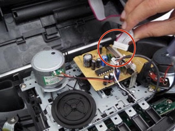

    • Start by unplugging the red and black cable connected to the motherboard
  7. Insignia NS-BCDCAS1 Cassette Door Latch Replacement: crwdns2935265:07crwdnd2935265:01crwdnd2935265:01crwdne2935265:0
    • Unplug the red and pink wires connecting the top of the device to the motherboard
  8. Insignia NS-BCDCAS1 Cassette Door Latch Replacement: crwdns2935265:08crwdnd2935265:01crwdnd2935265:03crwdne2935265:0 Insignia NS-BCDCAS1 Cassette Door Latch Replacement: crwdns2935265:08crwdnd2935265:02crwdnd2935265:03crwdne2935265:0 Insignia NS-BCDCAS1 Cassette Door Latch Replacement: crwdns2935265:08crwdnd2935265:03crwdnd2935265:03crwdne2935265:0

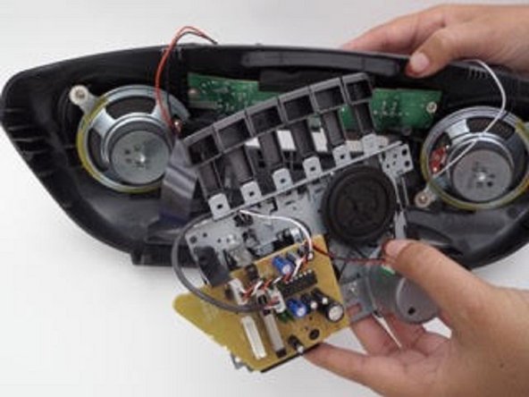

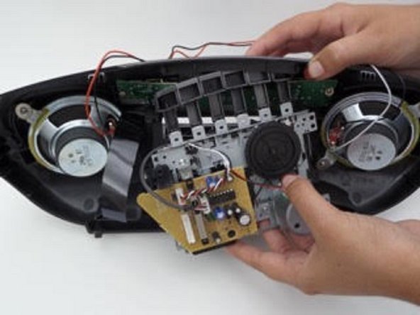

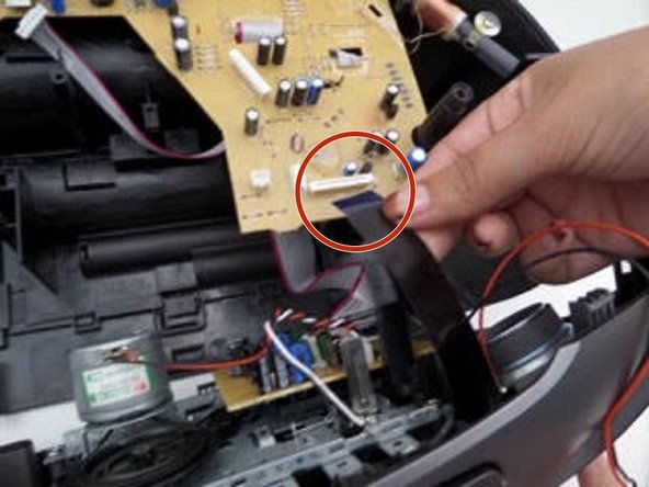

    • Disconnect the black shiny tape connecting the motherboard to the front of the device
    • Also disconnect the pink and white wires connecting the cassette unit to the device.
  9. Insignia NS-BCDCAS1 Cassette Door Latch Replacement: crwdns2935265:09crwdnd2935265:01crwdnd2935265:01crwdne2935265:0
    • After disconnecting all the wires, the front panel is now free and easy to work on.
