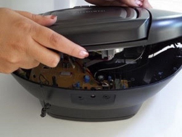

    • Turn the boombox around to view the back and lift the handle up.
    • Using the same driver with 2.5mm flathead, remove the two 14mm screws under the handle.
    • Gently lift the black top but do not pull completely away.
  6. Insignia NS-BCDCAS1 CD Laser Lens Replacement, CD Laser Lens: crwdns2935265:06crwdnd2935265:01crwdnd2935265:01crwdne2935265:0
    • Unplug the red and black wires from the large yellow motherboard by pulling upwards.
  7. Insignia NS-BCDCAS1 CD Laser Lens Replacement: crwdns2935265:07crwdnd2935265:01crwdnd2935265:01crwdne2935265:0
    • Unplug the thick, white and pink cord from underneath the black top by pulling downwards.

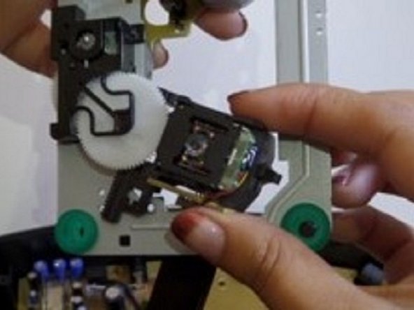

  11. Insignia NS-BCDCAS1 CD Laser Lens Replacement: crwdns2935265:011crwdnd2935265:01crwdnd2935265:01crwdne2935265:0
    • Using a JIS 1, remove the 8mm screw on the grey, square plate.

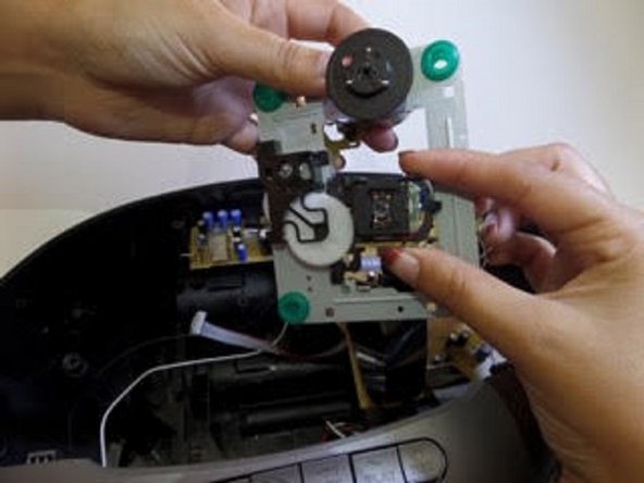

  12. Insignia NS-BCDCAS1 CD Laser Lens Replacement: crwdns2935265:012crwdnd2935265:01crwdnd2935265:03crwdne2935265:0 Insignia NS-BCDCAS1 CD Laser Lens Replacement: crwdns2935265:012crwdnd2935265:02crwdnd2935265:03crwdne2935265:0 Insignia NS-BCDCAS1 CD Laser Lens Replacement: crwdns2935265:012crwdnd2935265:03crwdnd2935265:03crwdne2935265:0
    • Slide the silver bar out.
    • Everything will be loosened. Support it with your hand
    • The square cube with the tiny lense is loosened. Slide it down to take out of the nook.
    • Detach the black tape so the cube is completely by itself. Replace the cube with a new one.
