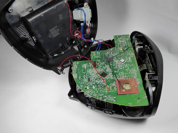

  4. Insignia NS-B4111 Speaker Replacement: crwdns2935265:04crwdnd2935265:01crwdnd2935265:02crwdne2935265:0 Insignia NS-B4111 Speaker Replacement: crwdns2935265:04crwdnd2935265:02crwdnd2935265:02crwdne2935265:0
    • Gently remove the bottom half of the casing from the top half of the casing.
    • The antenna base is connected to the motherboard by a red wire. This wire will prevent the two halves from separating completely.

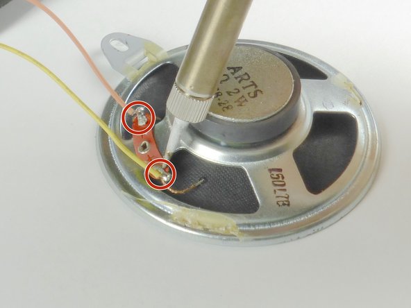

  16. Insignia NS-B4111 Speaker Replacement: crwdns2935265:016crwdnd2935265:01crwdnd2935265:02crwdne2935265:0 Insignia NS-B4111 Speaker Replacement: crwdns2935265:016crwdnd2935265:02crwdnd2935265:02crwdne2935265:0
    • Unsolder the two wires at the given points. If you need help soldering, see this guide.
    • The speaker has two colored wires attached to the orange plate: one attached to the positive (+) end, and the other attached to the negative (-) end.
    • The left speaker (shown) has a yellow wire on the positive (+) end, and an orange wire on the negative (-) end.
    • The right speaker (not shown) has a brown wire on the positive (+) end, and a red wire on the negative (-) end.
