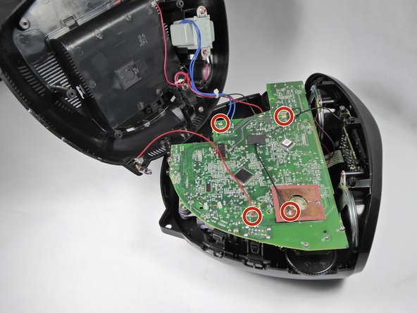

  6. Insignia NS-B4111 Motherboard Replacement, Motherboard: crwdns2935265:06crwdnd2935265:01crwdnd2935265:01crwdne2935265:0
    • Unscrew the four 12.5mm screws with the Phillips PH1 Screwdriver.
    • Unscrew the one 10mm long screw with the Phillips PH1 Screwdriver.
