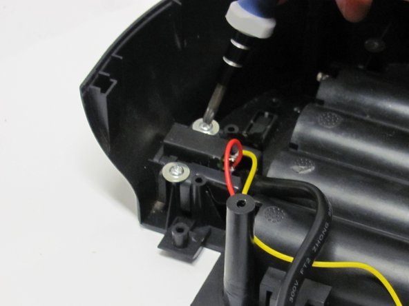

  3. Insignia NS-B2110 Transformer Replacement, Bottom Panel: crwdns2935265:03crwdnd2935265:01crwdnd2935265:01crwdne2935265:0
    • With a Phillips #2 screwdriver, remove two 2mm screws.
  4. Insignia NS-B2110 Transformer Replacement: crwdns2935265:04crwdnd2935265:01crwdnd2935265:02crwdne2935265:0 Insignia NS-B2110 Transformer Replacement: crwdns2935265:04crwdnd2935265:02crwdnd2935265:02crwdne2935265:0
    • Using a long Phillips #2 screwdriver, remove one 6mm screw located inside the battery compartment.
    • Use the same screwdriver to remove four more 6mm screws along the outside of the case.
  5. Insignia NS-B2110 Transformer Replacement: crwdns2935265:05crwdnd2935265:01crwdnd2935265:03crwdne2935265:0 Insignia NS-B2110 Transformer Replacement: crwdns2935265:05crwdnd2935265:02crwdnd2935265:03crwdne2935265:0 Insignia NS-B2110 Transformer Replacement: crwdns2935265:05crwdnd2935265:03crwdnd2935265:03crwdne2935265:0
    • With a plastic opening tool, wedge the bottom shell from the main speaker face along the edge.
    • The bottom cover has two red and two yellow wires attached to it that you don't want to pull off. Handle the casing carefully.
    • Once the pieces are separated, pull them apart and place the bottom cover aside, near the stereo.

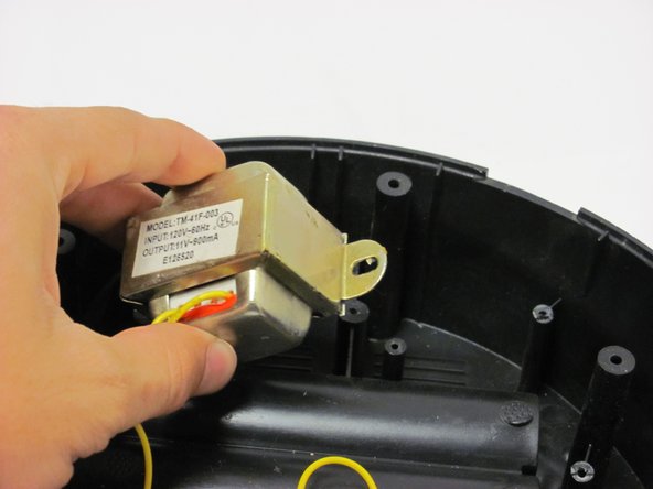

  6. Insignia NS-B2110 Transformer Replacement, Transformer: crwdns2935265:06crwdnd2935265:01crwdnd2935265:02crwdne2935265:0 Insignia NS-B2110 Transformer Replacement, Transformer: crwdns2935265:06crwdnd2935265:02crwdnd2935265:02crwdne2935265:0
    • Using a Phillips #2 screwdriver, remove two 4mm screws from the transformer box.
    • Remove the transformer and set it to the side.

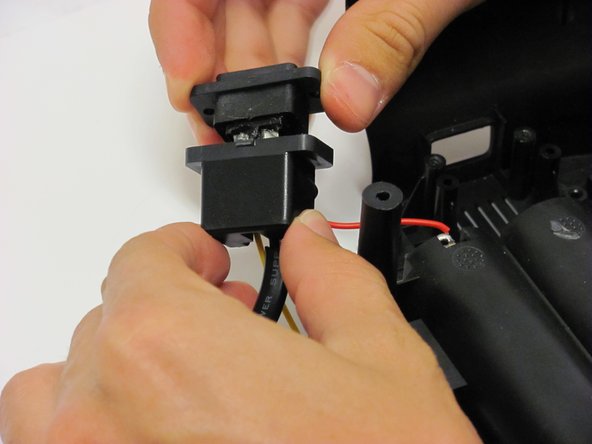

  8. Insignia NS-B2110 Transformer Replacement: crwdns2935265:08crwdnd2935265:01crwdnd2935265:03crwdne2935265:0 Insignia NS-B2110 Transformer Replacement: crwdns2935265:08crwdnd2935265:02crwdnd2935265:03crwdne2935265:0 Insignia NS-B2110 Transformer Replacement: crwdns2935265:08crwdnd2935265:03crwdnd2935265:03crwdne2935265:0
    • There will be a strip of electrical tape securing the converter. Use scissors to carefully remove this tape.
    • Use a Phillips #2 screwdriver to remove two 4mm screws from the converter.
    • Remove the converter. There will be a plastic casing that slides off; set this aside.
  9. Insignia NS-B2110 Transformer Replacement: crwdns2935265:09crwdnd2935265:01crwdnd2935265:01crwdne2935265:0
    • Remover the solder from the red and yellow wires on the converter.
