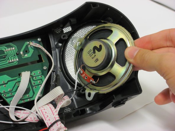

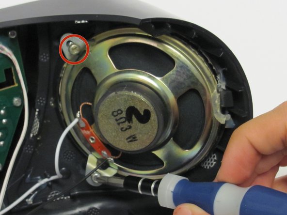

  14. Insignia NS-B2110 Speaker Replacement, Speaker: crwdns2935265:014crwdnd2935265:01crwdnd2935265:03crwdne2935265:0 Insignia NS-B2110 Speaker Replacement, Speaker: crwdns2935265:014crwdnd2935265:02crwdnd2935265:03crwdne2935265:0 Insignia NS-B2110 Speaker Replacement, Speaker: crwdns2935265:014crwdnd2935265:03crwdnd2935265:03crwdne2935265:0
    • Using a Phillips #2 Screwdriver, remove two 5mm screws from the speaker.
    • The edges of the speaker are very thin and sharp and could cut your finger.
    • The speaker will have a light coating of glue to hold it in place. A little force from your fingers will pull it right out. Remove the speaker and set it face-down on the table.
  15. Insignia NS-B2110 Speaker Replacement: crwdns2935265:015crwdnd2935265:01crwdnd2935265:01crwdne2935265:0
    • Remove the solder from the two black and white wires connected to the speaker.
