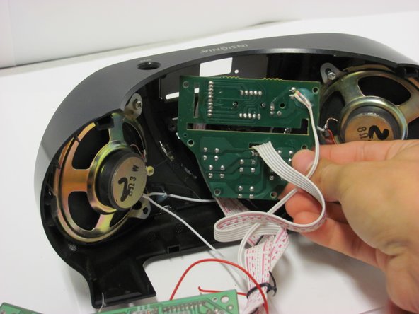

  6. Insignia NS-B2110 LED Display Replacement, Internal Components: crwdns2935265:06crwdnd2935265:01crwdnd2935265:02crwdne2935265:0 Insignia NS-B2110 LED Display Replacement, Internal Components: crwdns2935265:06crwdnd2935265:02crwdnd2935265:02crwdne2935265:0
    • With a Phillips #2 screwdriver, remove five 5mm screws from the "quarter circle" circuit board.
    • More wires! Handle the circuit board carefully and take caution not to stretch the red and white wires connected the board to the other components.
    • Remove the green quarter circle circuit board and place to the side.
  7. Insignia NS-B2110 LED Display Replacement: crwdns2935265:07crwdnd2935265:01crwdnd2935265:01crwdne2935265:0
    • On the brown side of the quarter circle circuit board, remove the two white ribbon cables with pink stripes attached to a plastic connector. To do this, pinch the tabs with your hands while pulling outward on the connector.
