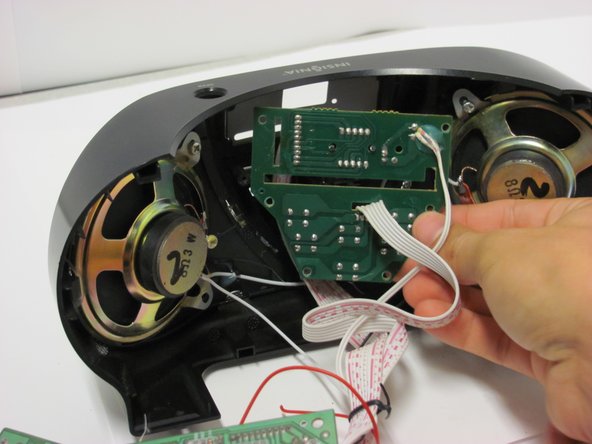

    • With a Phillips #2 screwdriver, remove five 5mm screws from the "quarter circle" circuit board.
    • More wires! Handle the circuit board carefully and take caution not to stretch the red and white wires connected the board to the other components.
    • Remove the green quarter circle circuit board and place to the side.
  7. Insignia NS-B2110 Button Replacement: crwdns2935265:07crwdnd2935265:01crwdnd2935265:01crwdne2935265:0
    • On the brown side of the quarter circle circuit board, remove the two white ribbon cables with pink stripes attached to a plastic connector. To do this, pinch the tabs with your hands while pulling outward on the connector.
  8. Insignia NS-B2110 Button Replacement: crwdns2935265:08crwdnd2935265:01crwdnd2935265:01crwdne2935265:0
    • With a Phillips #2 screwdriver, remove four 6mm screws from the rectangular circuit board.
  9. Insignia NS-B2110 Button Replacement: crwdns2935265:09crwdnd2935265:01crwdnd2935265:01crwdne2935265:0
    • Remove the two white ribbon cables attached to white plastic connectors from the circuit board by pinching the tabs with your hands and pulling outward on the connector.
  10. Insignia NS-B2110 Button Replacement: crwdns2935265:010crwdnd2935265:01crwdnd2935265:01crwdne2935265:0
    • Red and white wires are attached to this board as well. Once again, be careful not to stretch these.
    • Remove the rectangular circuit board and place it to the side.

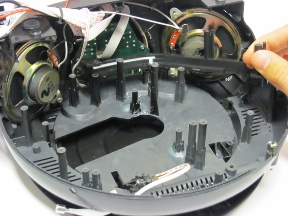

  11. Insignia NS-B2110 Button Replacement: crwdns2935265:011crwdnd2935265:01crwdnd2935265:01crwdne2935265:0
    • With a Phillips #2 screwdriver, remove two 5mm screws from the black plastic frame which previously held up the rectangular circuit board.
    • Remove the black plastic frame.

  13. Insignia NS-B2110 Button Replacement: crwdns2935265:013crwdnd2935265:01crwdnd2935265:01crwdne2935265:0
    • With a Phillips #2 screwdriver, remove the two 3mm screws from the black plastic tuner frame.
  14. Insignia NS-B2110 Button Replacement, Buttons: crwdns2935265:014crwdnd2935265:01crwdnd2935265:02crwdne2935265:0 Insignia NS-B2110 Button Replacement, Buttons: crwdns2935265:014crwdnd2935265:02crwdnd2935265:02crwdne2935265:0
    • The tuner is fragile and can snap easily. Handle it with care.
    • Remove the black plastic tuner assembly piece using the blue plastic opening tool.

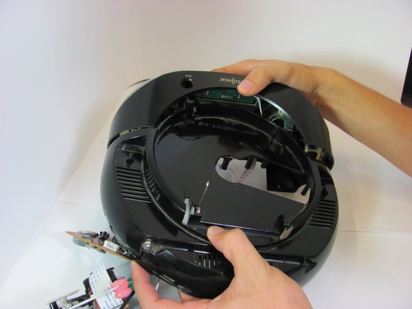

    • Turn the device so the CD tray faces up.
    • Use the blue plastic opening tool to separate the front half (containing the speakers and display) and the back half (containing the antenna).
    • When separating the device, keep in mind there are still wires attaches to the front half. Be careful not to damage these.
    • Pull the two plastic pieces apart. This will require a mild amount of force.

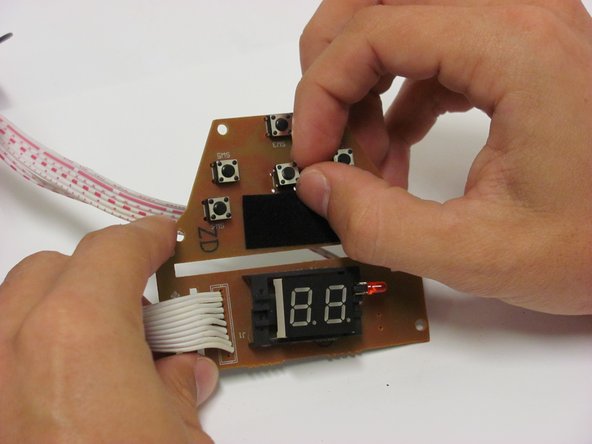

  16. Insignia NS-B2110 Button Replacement: crwdns2935265:016crwdnd2935265:01crwdnd2935265:02crwdne2935265:0 Insignia NS-B2110 Button Replacement: crwdns2935265:016crwdnd2935265:02crwdnd2935265:02crwdne2935265:0
    • Remove the six 5mm #2 Phillips head screws from the circuit board.
    • Remove the circuit board. This may require you to wiggle the board a little to get it free.
  17. Insignia NS-B2110 Button Replacement: crwdns2935265:017crwdnd2935265:01crwdnd2935265:02crwdne2935265:0 Insignia NS-B2110 Button Replacement: crwdns2935265:017crwdnd2935265:02crwdnd2935265:02crwdne2935265:0
    • Remove the solder from the back of the button. There are 4 points of solder for every button.
    • Remove the button from the circuit board.
To reassemble your device, follow these instructions in reverse order. Solder the wires back on where they have been soldered off.
