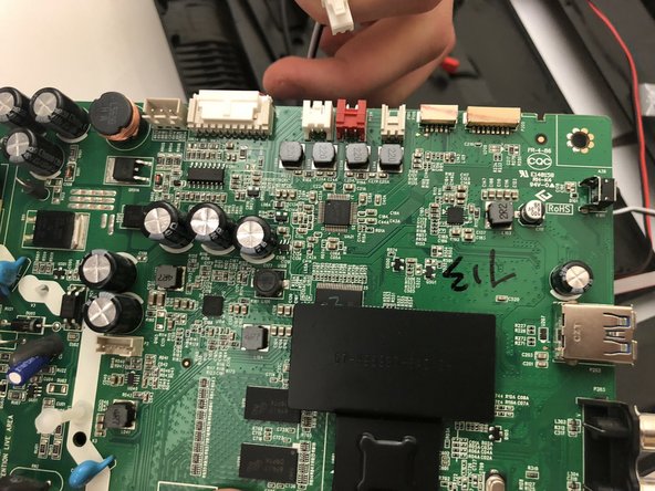

  6. Insignia NS-24ER310NA17 Speaker Replacement, Speaker: crwdns2935265:06crwdnd2935265:01crwdnd2935265:02crwdne2935265:0 Insignia NS-24ER310NA17 Speaker Replacement, Speaker: crwdns2935265:06crwdnd2935265:02crwdnd2935265:02crwdne2935265:0
    • Unplug the red (right speaker) cord from the motherboard.
    • Unplug the white (left speaker) cord from the motherboard.
