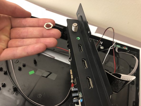

  16. Insignia NS-24ER310NA17 Input/Output Cover Replacement, Input/Output Board Covers: crwdns2935265:016crwdnd2935265:01crwdnd2935265:02crwdne2935265:0 Insignia NS-24ER310NA17 Input/Output Cover Replacement, Input/Output Board Covers: crwdns2935265:016crwdnd2935265:02crwdnd2935265:02crwdne2935265:0
    • After following the prerequisite guides, you should have the main board off with the black plastic still on. To remove the plastic, unscrew the nut that holds this plastic to the cable input on the board.
  17. Insignia NS-24ER310NA17 Input/Output Cover Replacement: crwdns2935265:017crwdnd2935265:01crwdnd2935265:01crwdne2935265:0
    • After removing the nut from the cable input, the black plastic should easily slide off of the inputs on the board. There are two separate pieces of plastic on the board, so be sure to remove both.
