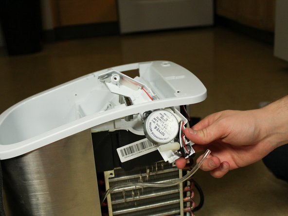

  4. Insignia Ice Maker NS-IMP26SS7 Water Pump Replacement: crwdns2935265:04crwdnd2935265:01crwdnd2935265:02crwdne2935265:0 Insignia Ice Maker NS-IMP26SS7 Water Pump Replacement: crwdns2935265:04crwdnd2935265:02crwdnd2935265:02crwdne2935265:0
    • Lift the Water Pump out of the way
  5. Insignia Ice Maker NS-IMP26SS7 Water Pump Replacement: crwdns2935265:05crwdnd2935265:01crwdnd2935265:03crwdne2935265:0 Insignia Ice Maker NS-IMP26SS7 Water Pump Replacement: crwdns2935265:05crwdnd2935265:02crwdnd2935265:03crwdne2935265:0 Insignia Ice Maker NS-IMP26SS7 Water Pump Replacement: crwdns2935265:05crwdnd2935265:03crwdnd2935265:03crwdne2935265:0

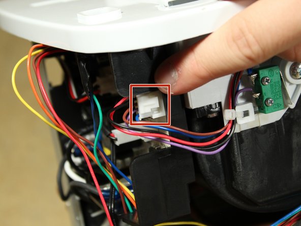

    • Remove the plastic cover from the circuit board by pressing the lever on the side. A pry tool may be required.
    • Disconnect the water tray cord.

  9. Insignia Ice Maker NS-IMP26SS7 Water Pump Replacement: crwdns2935265:09crwdnd2935265:01crwdnd2935265:02crwdne2935265:0 Insignia Ice Maker NS-IMP26SS7 Water Pump Replacement: crwdns2935265:09crwdnd2935265:02crwdnd2935265:02crwdne2935265:0
    • Disconnect the power supply as well as the control cables from the circuit board.
    • You may have to cut through some electrical tape to free the wires.

This is not fixing the water pump but instead the Synchronous Motor that moves the water tray mechanism where the freezing nozzles are. The water pump is located at the end of the clear tube at the bottom right of the unit (the side the fan is on). It literally has a friction fit that is on the other side of the screen you see in the water reservoir (bottom right). Both mine and another person (remember not to cut yourself) who made a video on YouTube’s problem was hair in the pump. Easy to take apart and either clean or replace (around $15). Thank you cats in my case! Most of these portable ice makers are the exact same on the inside and I’m sure massed produced in China then branded to reflect the price… ie you’re paying for the name in most cases! Good luck and happy fixing! - George
georgeApolymath - crwdns2934203:0crwdne2934203:0
I 2nd this, this is not the water pump but the water tray motor. The pump is on the bottom of the unit.
