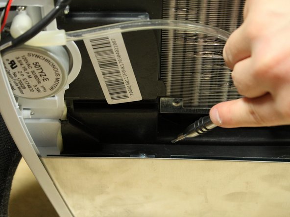

Insignia Ice Maker NS-IMP26SS7 Ice Tray Replacement
  1. Insignia Ice Maker NS-IMP26SS7 Ice Tray Replacement, Water Tray: crwdns2935265:01crwdnd2935265:01crwdnd2935265:03crwdne2935265:0 Insignia Ice Maker NS-IMP26SS7 Ice Tray Replacement, Water Tray: crwdns2935265:01crwdnd2935265:02crwdnd2935265:03crwdne2935265:0 Insignia Ice Maker NS-IMP26SS7 Ice Tray Replacement, Water Tray: crwdns2935265:01crwdnd2935265:03crwdnd2935265:03crwdne2935265:0
    • Remove the 6 screws holding the rear casing on.
    • Remove the rear casing
  2. Insignia Ice Maker NS-IMP26SS7 Ice Tray Replacement: crwdns2935265:02crwdnd2935265:01crwdnd2935265:03crwdne2935265:0 Insignia Ice Maker NS-IMP26SS7 Ice Tray Replacement: crwdns2935265:02crwdnd2935265:02crwdnd2935265:03crwdne2935265:0 Insignia Ice Maker NS-IMP26SS7 Ice Tray Replacement: crwdns2935265:02crwdnd2935265:03crwdnd2935265:03crwdne2935265:0
    • Remove the 4 screws holding the Ice Tray to the body of the Ice Maker.

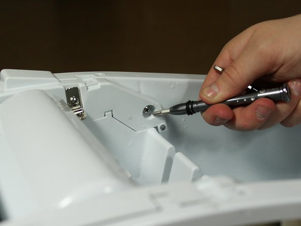

  3. Insignia Ice Maker NS-IMP26SS7 Ice Tray Replacement: crwdns2935265:03crwdnd2935265:01crwdnd2935265:03crwdne2935265:0 Insignia Ice Maker NS-IMP26SS7 Ice Tray Replacement: crwdns2935265:03crwdnd2935265:02crwdnd2935265:03crwdne2935265:0 Insignia Ice Maker NS-IMP26SS7 Ice Tray Replacement: crwdns2935265:03crwdnd2935265:03crwdnd2935265:03crwdne2935265:0
    • Remove the 4 screws holding the Ice Tray from the top.

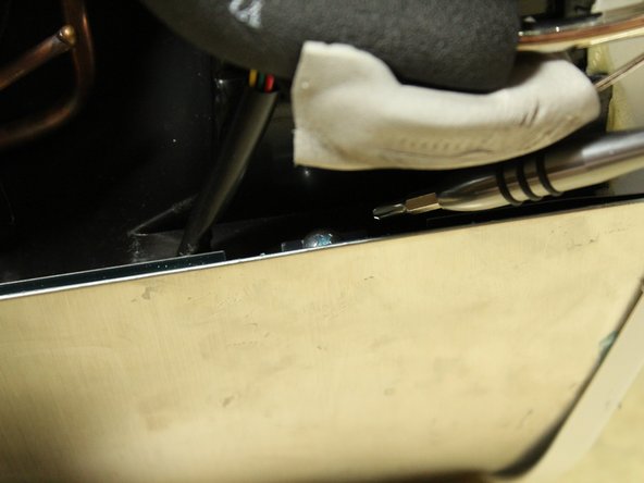

  5. Insignia Ice Maker NS-IMP26SS7 Ice Tray Replacement: crwdns2935265:05crwdnd2935265:01crwdnd2935265:03crwdne2935265:0 Insignia Ice Maker NS-IMP26SS7 Ice Tray Replacement: crwdns2935265:05crwdnd2935265:02crwdnd2935265:03crwdne2935265:0 Insignia Ice Maker NS-IMP26SS7 Ice Tray Replacement: crwdns2935265:05crwdnd2935265:03crwdnd2935265:03crwdne2935265:0
    • Remove the final 2 screws.
  6. Insignia Ice Maker NS-IMP26SS7 Ice Tray Replacement: crwdns2935265:06crwdnd2935265:01crwdnd2935265:03crwdne2935265:0 Insignia Ice Maker NS-IMP26SS7 Ice Tray Replacement: crwdns2935265:06crwdnd2935265:02crwdnd2935265:03crwdne2935265:0 Insignia Ice Maker NS-IMP26SS7 Ice Tray Replacement: crwdns2935265:06crwdnd2935265:03crwdnd2935265:03crwdne2935265:0
    • Remove the plastic cover from the circuit board by pressing the lever on the side. A pry tool may be required.
    • Disconnect the water tray cord.
