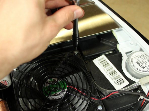

    • Locate the fan on the side of the Ice maker and undo the 4 screws holding it in place.

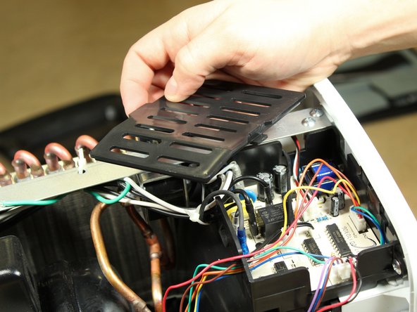

    • Remove the cover from the circuit board by pressing against the lever to the side. A pry tool may be needed.

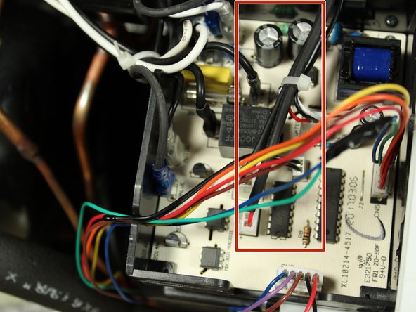

    • Follow the fan's power cable and unplug.
    • You may have to cut a zip tie holding the cable in place.
