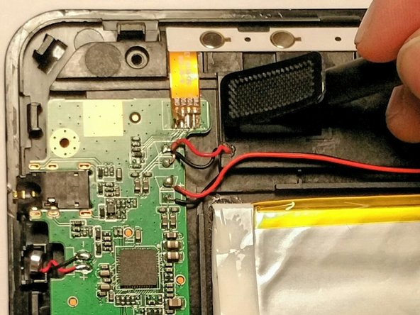

  11. Insignia Flex 8 Speakers Replacement, Speakers: crwdns2935265:011crwdnd2935265:01crwdnd2935265:02crwdne2935265:0 Insignia Flex 8 Speakers Replacement, Speakers: crwdns2935265:011crwdnd2935265:02crwdnd2935265:02crwdne2935265:0
    • Looking at the front of the speaker, peel back the rectangular cover to expose the speaker.
  12. Insignia Flex 8 Speakers Replacement: crwdns2935265:012crwdnd2935265:01crwdnd2935265:01crwdne2935265:0
    • Desolder the connections from the circuit board
    • Do not heat up the surrounding components on the circuit board.
  13. Insignia Flex 8 Speakers Replacement: crwdns2935265:013crwdnd2935265:01crwdnd2935265:01crwdne2935265:0
    • Turn the black internal mounting piece over to access the back of the speaker.
    • Use a spudger to lift the cover open.
    • The cover is attached with a plastic solder, be careful not to break the cover.
  14. Insignia Flex 8 Speakers Replacement: crwdns2935265:014crwdnd2935265:01crwdnd2935265:01crwdne2935265:0
    • Pull the speaker out of its housing.
    • Repeat these steps for the other speaker.
