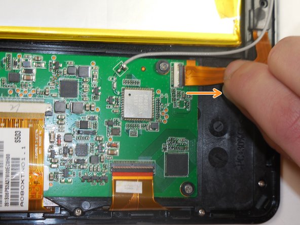

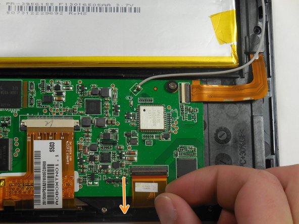

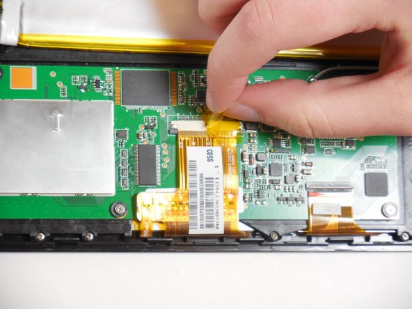

    • Peel tape off of ribbon connectors. Starting at the power button, work clockwise around the tablet.
  4. Insignia Flex 8 Screen Replacement: crwdns2935265:04crwdnd2935265:01crwdnd2935265:03crwdne2935265:0 Insignia Flex 8 Screen Replacement: crwdns2935265:04crwdnd2935265:02crwdnd2935265:03crwdne2935265:0 Insignia Flex 8 Screen Replacement: crwdns2935265:04crwdnd2935265:03crwdnd2935265:03crwdne2935265:0

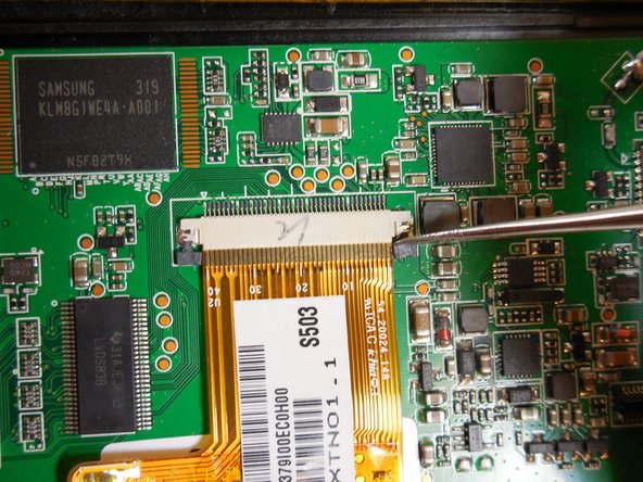

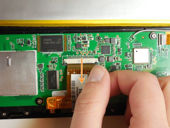

    • To remove the camera ribbon cable, lift the flap using a spudger.
    • Pull the ribbon directly back to release it.

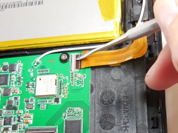

  5. Insignia Flex 8 Screen Replacement: crwdns2935265:05crwdnd2935265:01crwdnd2935265:03crwdne2935265:0 Insignia Flex 8 Screen Replacement: crwdns2935265:05crwdnd2935265:02crwdnd2935265:03crwdne2935265:0 Insignia Flex 8 Screen Replacement: crwdns2935265:05crwdnd2935265:03crwdnd2935265:03crwdne2935265:0
    • Remove the second ribbon cable by prying up the black flap using a spudger.
    • Pull the ribbon cable horizontally directly away from the battery.

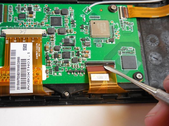

  6. Insignia Flex 8 Screen Replacement: crwdns2935265:06crwdnd2935265:01crwdnd2935265:03crwdne2935265:0 Insignia Flex 8 Screen Replacement: crwdns2935265:06crwdnd2935265:02crwdnd2935265:03crwdne2935265:0 Insignia Flex 8 Screen Replacement: crwdns2935265:06crwdnd2935265:03crwdnd2935265:03crwdne2935265:0
    • Remove the final ribbon cable by pulling back the two black tabs on either side of the ribbon cable.
    • Pull the ribbon horizontally directly away from the battery.

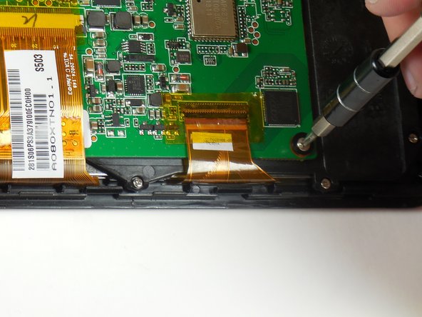

    • Unscrew the thirteen 4.75mm screws around the perimeter of the tablet using a PH 00 screwdriver.
  8. Insignia Flex 8 Screen Replacement: crwdns2935265:08crwdnd2935265:01crwdnd2935265:02crwdne2935265:0 Insignia Flex 8 Screen Replacement: crwdns2935265:08crwdnd2935265:02crwdnd2935265:02crwdne2935265:0

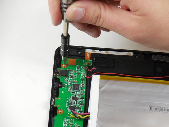

    • Unscrew the four 3.75mm screws and plastic washers using a PH 00 screwdriver.
    • Lift up the circuit board.
