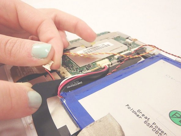

  3. Insignia Flex 8 NS-P16AT08 Speakers Replacement, Speakers: crwdns2935265:03crwdnd2935265:01crwdnd2935265:02crwdne2935265:0 Insignia Flex 8 NS-P16AT08 Speakers Replacement, Speakers: crwdns2935265:03crwdnd2935265:02crwdnd2935265:02crwdne2935265:0
    • There are two connections that attach the speakers to the motherboard.
    • Unplug the cables from the motherboard by gently pulling them away.
    • Speaker cables will be free to be removed.

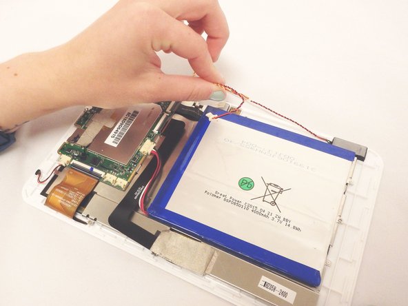

  4. Insignia Flex 8 NS-P16AT08 Speakers Replacement: crwdns2935265:04crwdnd2935265:01crwdnd2935265:02crwdne2935265:0 Insignia Flex 8 NS-P16AT08 Speakers Replacement: crwdns2935265:04crwdnd2935265:02crwdnd2935265:02crwdne2935265:0
    • Remove the tape that is holding the speaker cables down.
    • Remove the speaker cables from underneath the black connector ribbons.
    • The cables are hooked underneath black connector ribbons; carefully unhook them.
