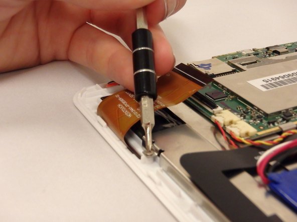

  3. Insignia Flex 8 NS-P16AT08 Screen Replacement, Screen: crwdns2935265:03crwdnd2935265:01crwdnd2935265:02crwdne2935265:0 Insignia Flex 8 NS-P16AT08 Screen Replacement, Screen: crwdns2935265:03crwdnd2935265:02crwdnd2935265:02crwdne2935265:0
    • Pull gently on the cable that connects the microphone to the motherboard.
    • The microphone will stay attached to device and separated from motherboard.

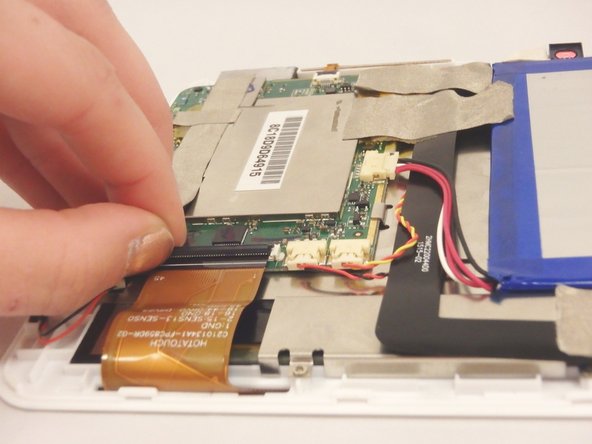

  4. Insignia Flex 8 NS-P16AT08 Screen Replacement: crwdns2935265:04crwdnd2935265:01crwdnd2935265:02crwdne2935265:0 Insignia Flex 8 NS-P16AT08 Screen Replacement: crwdns2935265:04crwdnd2935265:02crwdnd2935265:02crwdne2935265:0
    • Flip up the black flap of the connector ribbon that connects the screen to the motherboard.
    • Connector ribbon will stay attached to the device and separted from the motherboard.
    • If the black flap of connector will not lift by using your finger, then use the nylon spudger.
  5. Insignia Flex 8 NS-P16AT08 Screen Replacement: crwdns2935265:05crwdnd2935265:01crwdnd2935265:01crwdne2935265:0
    • Gently pull the connector ribbon by hand from the connector until it separates from connector.

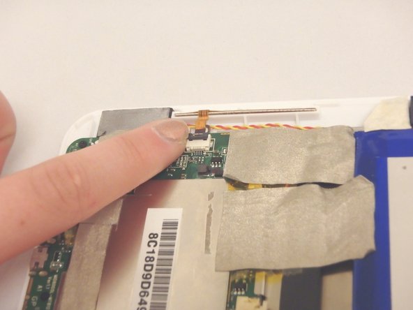

  6. Insignia Flex 8 NS-P16AT08 Screen Replacement: crwdns2935265:06crwdnd2935265:01crwdnd2935265:02crwdne2935265:0 Insignia Flex 8 NS-P16AT08 Screen Replacement: crwdns2935265:06crwdnd2935265:02crwdnd2935265:02crwdne2935265:0
    • Flip up the black flap of the connector ribbon that connects the buttons to the motherboard.
    • The connector ribbon will stay attached to the device and separted from the motherboard.
    • If the black flap of the connector will not lift by using your finger, then use the nylon spudger.

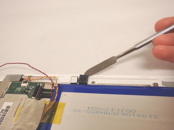

  8. Insignia Flex 8 NS-P16AT08 Screen Replacement: crwdns2935265:08crwdnd2935265:01crwdnd2935265:02crwdne2935265:0 Insignia Flex 8 NS-P16AT08 Screen Replacement: crwdns2935265:08crwdnd2935265:02crwdnd2935265:02crwdne2935265:0
    • Gently pry the cameras from device using metal spudger tool.
    • Always try using a plastic opening tool or nylon spudger first. Metal spudgers are great for serious prying power but can damage your device if used incorrectly.
    • The cameras and connector ribbon will stay attached to motherboard.

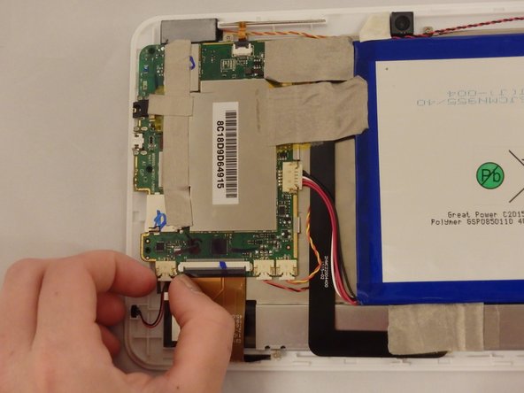

  9. Insignia Flex 8 NS-P16AT08 Screen Replacement: crwdns2935265:09crwdnd2935265:01crwdnd2935265:01crwdne2935265:0
    • Remove the tape that is covering the screen motherboard connector ribbon.
    • The screen connection will now be exposed.

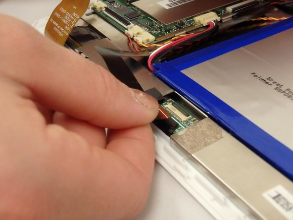

  10. Insignia Flex 8 NS-P16AT08 Screen Replacement: crwdns2935265:010crwdnd2935265:01crwdnd2935265:02crwdne2935265:0 Insignia Flex 8 NS-P16AT08 Screen Replacement: crwdns2935265:010crwdnd2935265:02crwdnd2935265:02crwdne2935265:0
    • Flip up the black flap of the connector that connects the screen to the motherboard.
    • Gently pull the connector ribbon by hand from the connector until it separates from the connector.
    • The connector ribbon will remain attached to the motherboard and separated from the screen.
