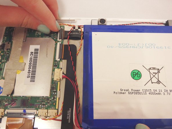

    • Locate camera ribbon connector.
    • Using finger flip up black flap of camera ribbon connector.
  5. Insignia Flex 8 NS-P16AT08 Cameras Replacement: crwdns2935265:05crwdnd2935265:01crwdnd2935265:01crwdne2935265:0
    • Gently pull camera connector ribbon by hand until it separates from connector.
