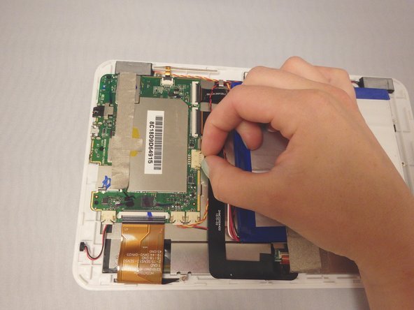

  3. Insignia Flex 8 NS-P16AT08 Battery Replacement, Battery: crwdns2935265:03crwdnd2935265:01crwdnd2935265:01crwdne2935265:0
    • Gently peel the tape that is covering the cable connections going to and from the battery and set tape aside.
    • This will expose the cable connections in preparation for disconnecting the cables and battery.
  4. Insignia Flex 8 NS-P16AT08 Battery Replacement: crwdns2935265:04crwdnd2935265:01crwdnd2935265:02crwdne2935265:0 Insignia Flex 8 NS-P16AT08 Battery Replacement: crwdns2935265:04crwdnd2935265:02crwdnd2935265:02crwdne2935265:0
    • Locate battery cable connection.
    • Pull gently on cable that connects the battery to the motherboard.
    • Cable will stay attached to battery but be removed from motherboard.
    • If pulling gently doesn't loosen cable, wiggle connection while pulling gently.
