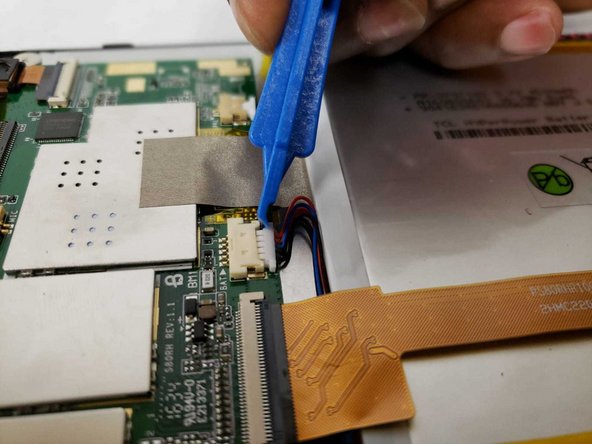

    • Use the opening tool to remove the battery cable from the circuit board.

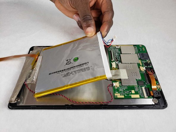

    • Pry the battery from the back of the LCD screen using the opening tool. Due to the strong adhesive between the battery and screen, this may take some time.
