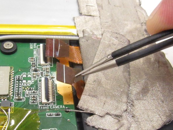

  4. Insignia Flex 8 NS-15AT08 Cameras Replacement: crwdns2935265:04crwdnd2935265:01crwdnd2935265:02crwdne2935265:0 Insignia Flex 8 NS-15AT08 Cameras Replacement: crwdns2935265:04crwdnd2935265:02crwdnd2935265:02crwdne2935265:0
    • Use tweezers to gently pull on both orange camera ribbons in the opposite direction in which they are connected until they disconnect from the modules on the circuit board.
  5. Insignia Flex 8 NS-15AT08 Cameras Replacement: crwdns2935265:05crwdnd2935265:01crwdnd2935265:02crwdne2935265:0 Insignia Flex 8 NS-15AT08 Cameras Replacement: crwdns2935265:05crwdnd2935265:02crwdnd2935265:02crwdne2935265:0
    • Peel off the grey tape covering the ribbons, in order to separate the cameras and their respective ribbons from the rest of the device.
    • Do not use excessive force while removing the tape to prevent tears in the ribbons.

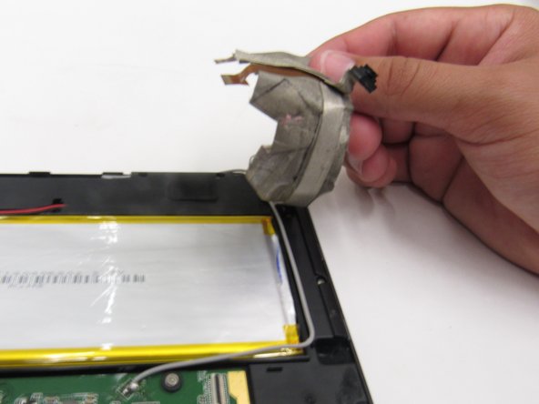

  6. Insignia Flex 8 NS-15AT08 Cameras Replacement: crwdns2935265:06crwdnd2935265:01crwdnd2935265:01crwdne2935265:0
    • Use a a plastic opening tool to pry out the back camera at the top of the circuit board.
