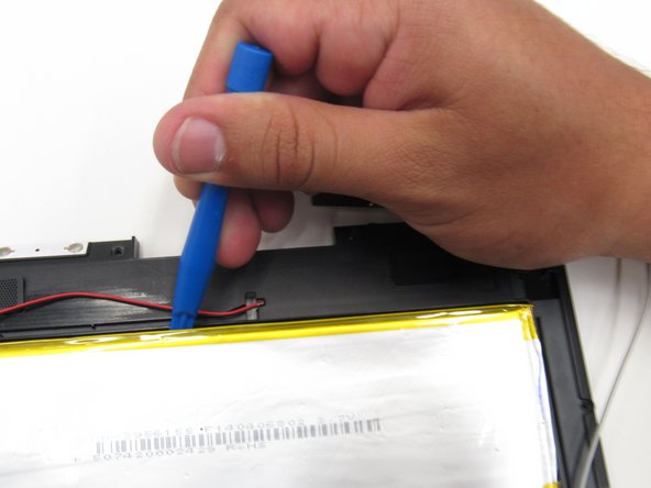

    • Insert a plastic opening tool into the seam between the back casing and the screen to separate the back casing from the tablet.
    • You may need to use a metal opening tool for extra prying power, but beware that it can scratch your device or damage the internal components if the tool is inserted too deep.
    • You will hear the tabs pop as you separate the back casing around the tablet.
  2. Insignia Flex 8 NS-15AT08 Battery Replacement: crwdns2935265:02crwdnd2935265:01crwdnd2935265:02crwdne2935265:0 Insignia Flex 8 NS-15AT08 Battery Replacement: crwdns2935265:02crwdnd2935265:02crwdnd2935265:02crwdne2935265:0

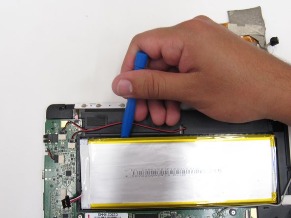

    • Lift the back casing away from the rest of the device which should include the exposed circuit board and screen.
    • Set the casing aside.

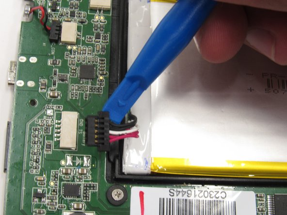

  3. Insignia Flex 8 NS-15AT08 Battery Replacement, Battery: crwdns2935265:03crwdnd2935265:01crwdnd2935265:02crwdne2935265:0 Insignia Flex 8 NS-15AT08 Battery Replacement, Battery: crwdns2935265:03crwdnd2935265:02crwdnd2935265:02crwdne2935265:0
    • Wedge a plastic opening tool in between the male, black module and female, white module to disconnect the wires module from the circuit board.

    • Use a plastic opening tool to pry the battery from the circuit board by wedging it around the perimeter of the battery.
  5. Insignia Flex 8 NS-15AT08 Battery Replacement: crwdns2935265:05crwdnd2935265:01crwdnd2935265:01crwdne2935265:0
    • Remove the battery from the circuit board by lifting it with the spudger or finger.
