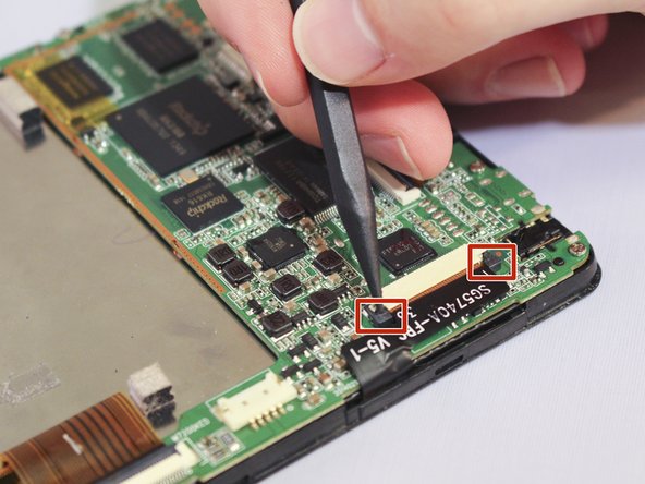

    • Place the tip of the spudger on each side of the battery's electrical connector.
    • Then using a gentle match-striking motion, loosen both sides of the battery's electrical connector.

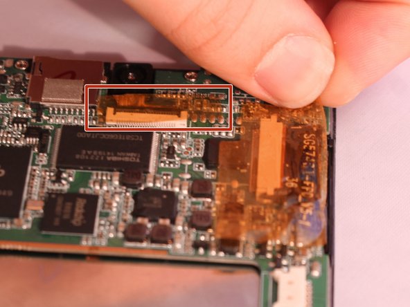

    • Locate the three ribbon cables connecting components to the motherboard. The connections are covered with orange shielding tape. Peel the tape off the connectors and reserve for reassembly.

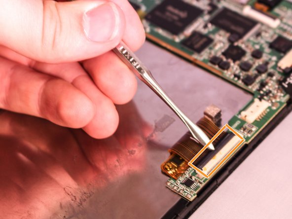

    • Each Zero Insertion Force or ZIF connector has a latch which holds the ribbon cable in place. The camera cable (a) and the LCD display cable (b) have a latch that lifts as shown in the illustration. Use a spudger to gently lift the latch to release the cable.
    • The touchscreen cable (c) has a sliding latch on each side of the connector. Use a spudger to carefully slide the latch on each side as shown to release the cable.

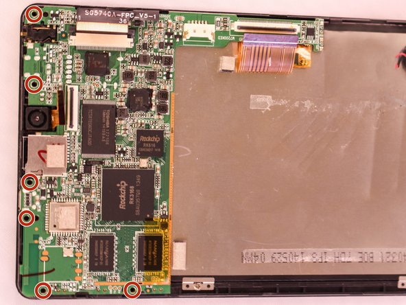

    • Using a Phillips #000 screwdriver, unscrew the six 4.8mm screws holding the motherboard to the case.
    • Using the spudger lift the motherboard from the case.

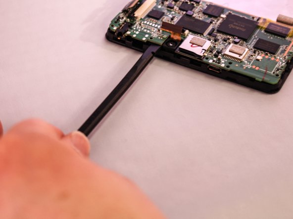

  7. Insignia Flex 7 Camera Assembly Replacement, Camera Assembly: crwdns2935265:07crwdnd2935265:01crwdnd2935265:03crwdne2935265:0 Insignia Flex 7 Camera Assembly Replacement, Camera Assembly: crwdns2935265:07crwdnd2935265:02crwdnd2935265:03crwdne2935265:0 Insignia Flex 7 Camera Assembly Replacement, Camera Assembly: crwdns2935265:07crwdnd2935265:03crwdnd2935265:03crwdne2935265:0

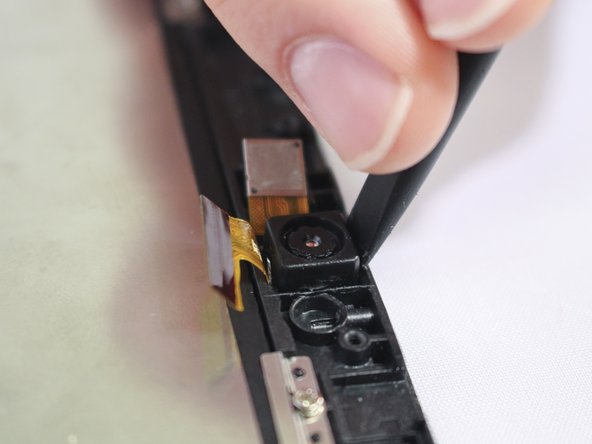

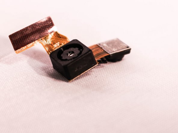

    • Insert the flat end of the spudger into the groove between the external camera and the tablet's plastic case. Then, applying a gentle prying motion on both sides of the camera, loosen the glue holding down the external camera to separate it from the plastic case.
