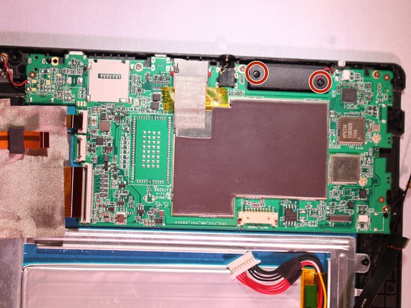

  5. Insignia Flex 11.6 Speakers Replacement, Speakers: crwdns2935265:05crwdnd2935265:01crwdnd2935265:01crwdne2935265:0
    • Remove 2 electrical connectors that connects to the speaker using flat tweezers.
  6. Insignia Flex 11.6 Speakers Replacement: crwdns2935265:06crwdnd2935265:01crwdnd2935265:02crwdne2935265:0 Insignia Flex 11.6 Speakers Replacement: crwdns2935265:06crwdnd2935265:02crwdnd2935265:02crwdne2935265:0
    • Remove 2 - 6 mm J000 Phillips screws from each of the speakers.
    • Speakers will pop out at this point.
