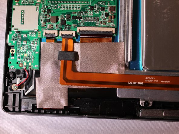

    • Peel the yellow tape off from on top of the electrical connectors.

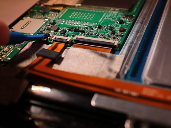

  7. Insignia Flex 11.6 Screen Replacement: crwdns2935265:07crwdnd2935265:01crwdnd2935265:02crwdne2935265:0 Insignia Flex 11.6 Screen Replacement: crwdns2935265:07crwdnd2935265:02crwdnd2935265:02crwdne2935265:0
    • Flip up the black cover pieces to expose the 3 electrical connectors.
    • Remove 3 electrical connectors by gently pulling back on them with some tweezers.

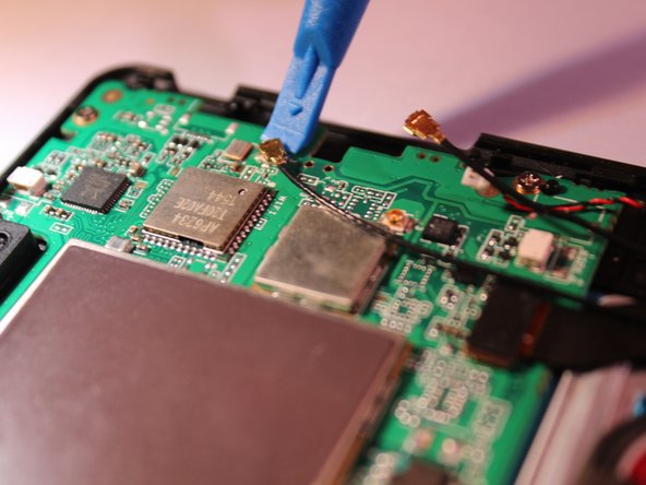

    • Unplug the 2 black ground wires from the motherboard by gently prying on them until they unhook from the motherboard.
    • Remove the black camera connector by gently prying on it until it unhooks.

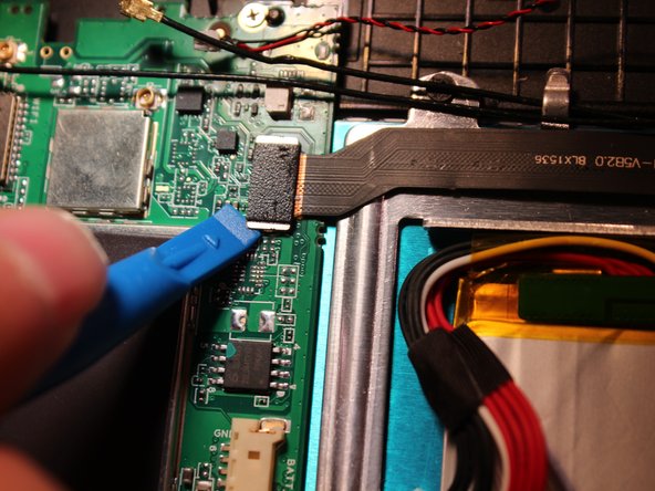

    • Peel back the copper color electrical connector with blue opening tool.
