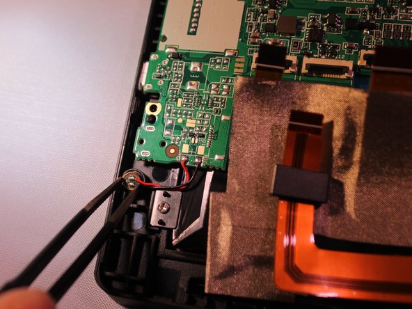

  9. Insignia Flex 11.6 Motherboard Replacement: crwdns2935265:09crwdnd2935265:01crwdnd2935265:02crwdne2935265:0 Insignia Flex 11.6 Motherboard Replacement: crwdns2935265:09crwdnd2935265:02crwdnd2935265:02crwdne2935265:0
    • Using tweezers, remove the microphone from the the plastic cover.
  10. Insignia Flex 11.6 Motherboard Replacement: crwdns2935265:010crwdnd2935265:01crwdnd2935265:01crwdne2935265:0
    • Remove 5 - 3.4 mm Phillips J000 screws from the motherboard.
    • Motherboard pops out.
