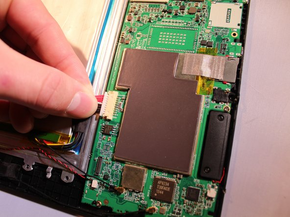

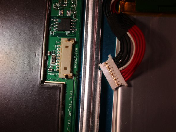

    • Remove the electrical connector that connects to the battery to remove the power to the battery.

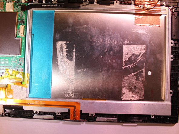

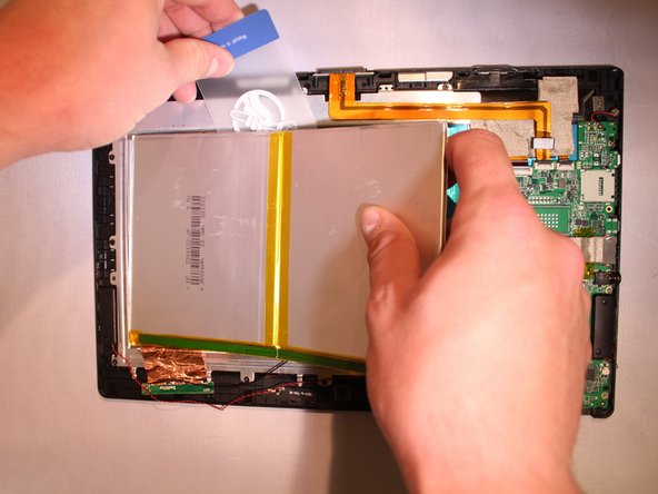

    • Make sure not to bend the battery too excessively as if bent too much, it could rupture a cell within the battery and possibly cause a fire.
    • The battery is glued onto the device. To remove it, use a nylon spudger or plastic card to slide underneath the battery and scrape back and forth to remove the glue until the battery is removed from the device.
