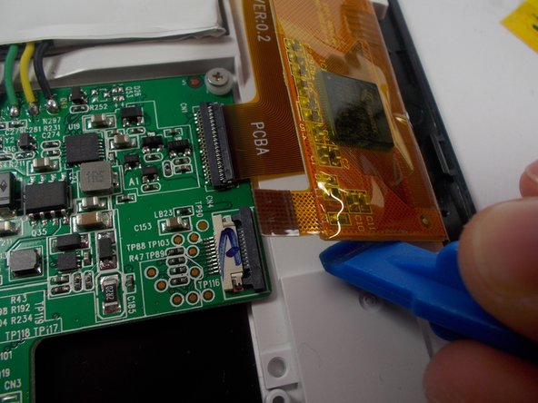

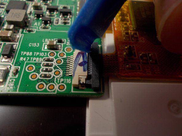

      • Peel off the tape covering the two connections labeled in red.
    7. Insignia Flex 10.1 Screen Replacement: crwdns2935265:07crwdnd2935265:01crwdnd2935265:03crwdne2935265:0 Insignia Flex 10.1 Screen Replacement: crwdns2935265:07crwdnd2935265:02crwdnd2935265:03crwdne2935265:0 Insignia Flex 10.1 Screen Replacement: crwdns2935265:07crwdnd2935265:03crwdnd2935265:03crwdne2935265:0

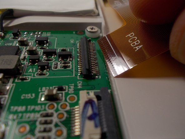

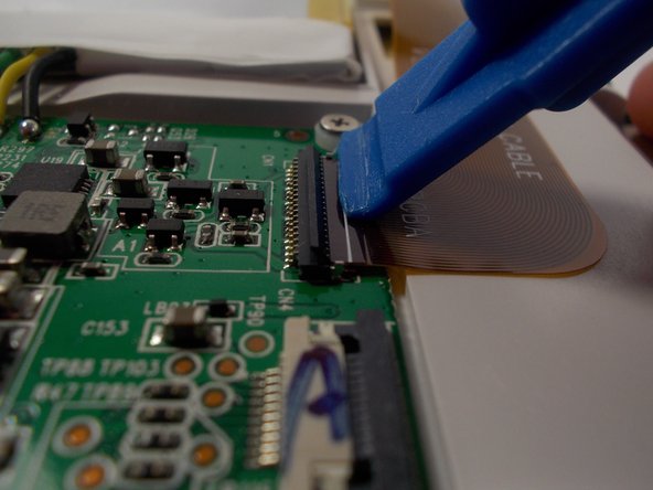

      • Remove the ribbon cable by lifting up on the connection with a plastic opening tool and pulling out the ribbon cable.
    8. Insignia Flex 10.1 Screen Replacement: crwdns2935265:08crwdnd2935265:01crwdnd2935265:03crwdne2935265:0 Insignia Flex 10.1 Screen Replacement: crwdns2935265:08crwdnd2935265:02crwdnd2935265:03crwdne2935265:0 Insignia Flex 10.1 Screen Replacement: crwdns2935265:08crwdnd2935265:03crwdnd2935265:03crwdne2935265:0

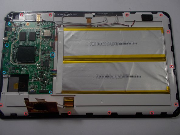

      • Use a Phillips #0 screwdriver to unscrew the 17 screws labeled in red.
    10. Insignia Flex 10.1 Screen Replacement: crwdns2935265:010crwdnd2935265:01crwdnd2935265:02crwdne2935265:0 Insignia Flex 10.1 Screen Replacement: crwdns2935265:010crwdnd2935265:02crwdnd2935265:02crwdne2935265:0

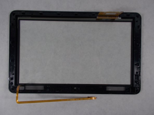

      • Separate the whole assembly from the screen, being careful and ensuring you removed everything necessary.
    11. Insignia Flex 10.1 Screen Replacement: crwdns2935265:011crwdnd2935265:01crwdnd2935265:01crwdne2935265:0

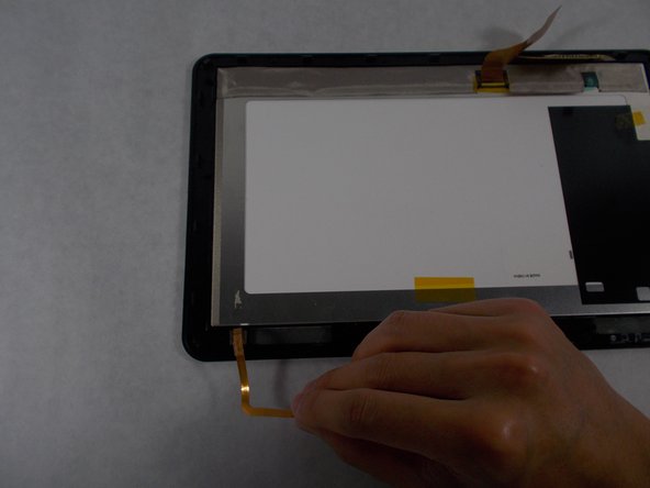

      • With the screws and white plastic cover removed, the screen and glass panel is exposed.
    12. Insignia Flex 10.1 Screen Replacement: crwdns2935265:012crwdnd2935265:01crwdnd2935265:02crwdne2935265:0 Insignia Flex 10.1 Screen Replacement: crwdns2935265:012crwdnd2935265:02crwdnd2935265:02crwdne2935265:0

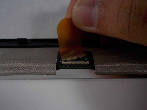

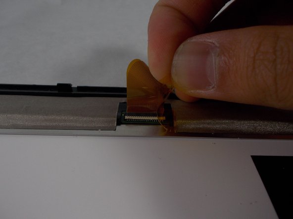

      • Peel back the ribbon cable resting on the screen.
    13. Insignia Flex 10.1 Screen Replacement: crwdns2935265:013crwdnd2935265:01crwdnd2935265:03crwdne2935265:0 Insignia Flex 10.1 Screen Replacement: crwdns2935265:013crwdnd2935265:02crwdnd2935265:03crwdne2935265:0 Insignia Flex 10.1 Screen Replacement: crwdns2935265:013crwdnd2935265:03crwdnd2935265:03crwdne2935265:0
      • Remove the tape covering the connection.
      • Disconnect the ribbon cable from the screen by lifting up on the connection and pulling out the ribbon cable.
    14. Insignia Flex 10.1 Screen Replacement: crwdns2935265:014crwdnd2935265:01crwdnd2935265:03crwdne2935265:0 Insignia Flex 10.1 Screen Replacement: crwdns2935265:014crwdnd2935265:02crwdnd2935265:03crwdne2935265:0 Insignia Flex 10.1 Screen Replacement: crwdns2935265:014crwdnd2935265:03crwdnd2935265:03crwdne2935265:0

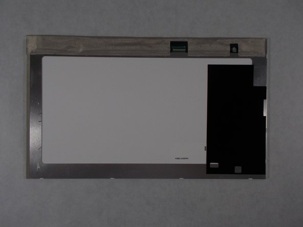

      • The screen is now free. Lift the screen out of the glass panel. The screen can now be replaced.
