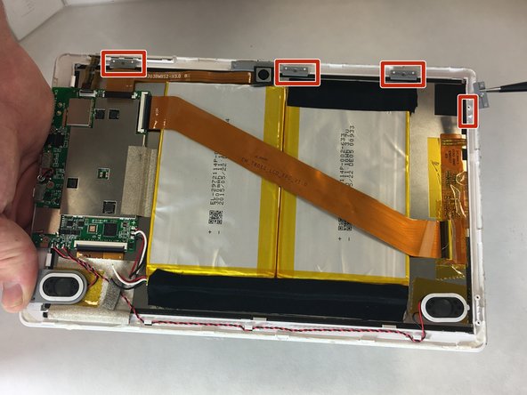

    • Use a Phillips head #00 screw driver to remove the thirteen screws.
  3. Insignia Flex 10.1 NS-P16AT10 Screen Replacement: crwdns2935265:03crwdnd2935265:01crwdnd2935265:02crwdne2935265:0 Insignia Flex 10.1 NS-P16AT10 Screen Replacement: crwdns2935265:03crwdnd2935265:02crwdnd2935265:02crwdne2935265:0
    • Use tweezers to remove the gray pieces located around the speakers and four screws that were removed in the previous step.
    • There should be six grey pieces total.

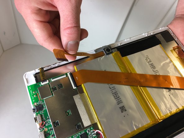

    • Use a plastic opening tool to flip up the ribbon cable connector that connects the camera to the motherboard.
  5. Insignia Flex 10.1 NS-P16AT10 Screen Replacement: crwdns2935265:05crwdnd2935265:01crwdnd2935265:01crwdne2935265:0
    • Gently lift the camera lens up from the front case.
  6. Insignia Flex 10.1 NS-P16AT10 Screen Replacement: crwdns2935265:06crwdnd2935265:01crwdnd2935265:02crwdne2935265:0 Insignia Flex 10.1 NS-P16AT10 Screen Replacement: crwdns2935265:06crwdnd2935265:02crwdnd2935265:02crwdne2935265:0
    • Use a plastic opening tool to flip the ribbon connector up in order to free the ribbon cable from the motherboard.

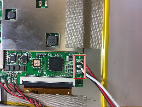

    • Free the battery from the motherboard by desoldering the red, white, and black connections one by one.
    • For soldering instructions, visit this guide.
    • Remove the soldering tip immediately once the wire has become free. Too much heat can damage the motherboard.

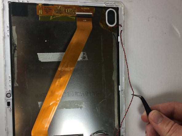

  10. Insignia Flex 10.1 NS-P16AT10 Screen Replacement: crwdns2935265:010crwdnd2935265:01crwdnd2935265:02crwdne2935265:0 Insignia Flex 10.1 NS-P16AT10 Screen Replacement: crwdns2935265:010crwdnd2935265:02crwdnd2935265:02crwdne2935265:0
    • Use tweezers to free the twisted, red and black wire from the three clips on the front case.

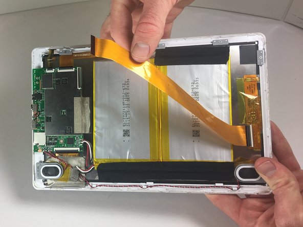

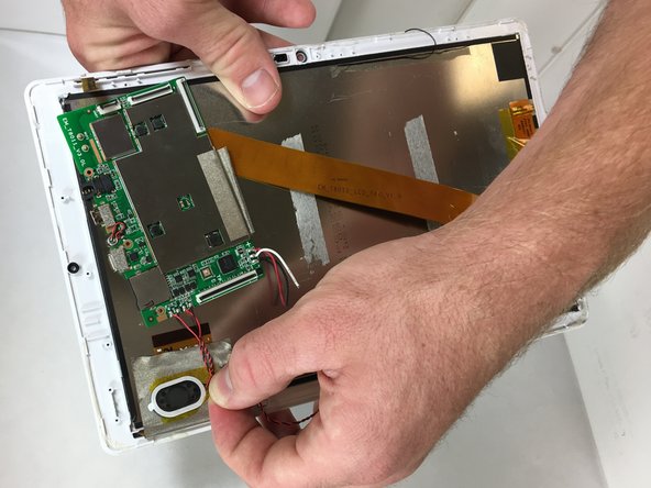

    • Use a plastic opening tool to flip up the ribbon cable connectors that connect the touch digitizer to the motherboard.
  13. Insignia Flex 10.1 NS-P16AT10 Screen Replacement: crwdns2935265:013crwdnd2935265:01crwdnd2935265:03crwdne2935265:0 Insignia Flex 10.1 NS-P16AT10 Screen Replacement: crwdns2935265:013crwdnd2935265:02crwdnd2935265:03crwdne2935265:0 Insignia Flex 10.1 NS-P16AT10 Screen Replacement: crwdns2935265:013crwdnd2935265:03crwdnd2935265:03crwdne2935265:0

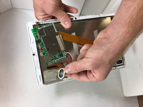

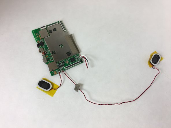

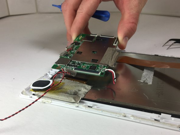

    • Gently lift the gray mesh tape up that holds the motherboard down to the front case.
    • Lift the motherboard up from the front case.
    • The speakers are directly connected to the motherboard and will come up with the motherboard.

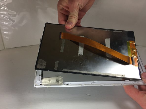

    • Use a plastic opening tool to separate the front case from the LCD screen.
    • Insert the plastic opening tool between the front case and rear LCD screen. Use a prying motion to lift the LCD screen from the front case.

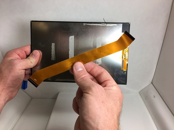

  16. Insignia Flex 10.1 NS-P16AT10 Screen Replacement: crwdns2935265:016crwdnd2935265:01crwdnd2935265:02crwdne2935265:0 Insignia Flex 10.1 NS-P16AT10 Screen Replacement: crwdns2935265:016crwdnd2935265:02crwdnd2935265:02crwdne2935265:0
    • Use a plastic opening tool to flip up the last ribbon cable on the screen.
    • Free the ribbon cable from the LCD screen.

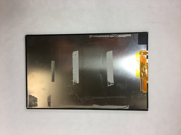

  17. Insignia Flex 10.1 NS-P16AT10 Screen Replacement: crwdns2935265:017crwdnd2935265:01crwdnd2935265:02crwdne2935265:0 Insignia Flex 10.1 NS-P16AT10 Screen Replacement: crwdns2935265:017crwdnd2935265:02crwdnd2935265:02crwdne2935265:0
    • The screen is now free and ready to be replaced.
