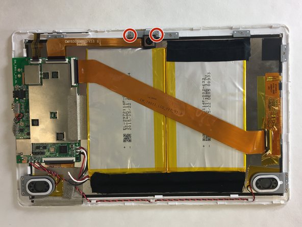

  3. Insignia Flex 10.1 NS-P16AT10 Camera Replacement: crwdns2935265:03crwdnd2935265:01crwdnd2935265:02crwdne2935265:0 Insignia Flex 10.1 NS-P16AT10 Camera Replacement: crwdns2935265:03crwdnd2935265:02crwdnd2935265:02crwdne2935265:0
    • Use a #00 Phillips head screw driver to remove the two screws that hold the camera down to the front case.

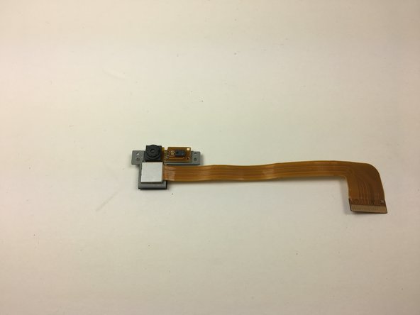

  4. Insignia Flex 10.1 NS-P16AT10 Camera Replacement: crwdns2935265:04crwdnd2935265:01crwdnd2935265:01crwdne2935265:0
    • Use tweezers or your fingers to remove the camera from your Insignia Flex 10.1 NS-P16AT10.
  5. Insignia Flex 10.1 NS-P16AT10 Camera Replacement: crwdns2935265:05crwdnd2935265:01crwdnd2935265:02crwdne2935265:0 Insignia Flex 10.1 NS-P16AT10 Camera Replacement: crwdns2935265:05crwdnd2935265:02crwdnd2935265:02crwdne2935265:0
    • The camera is now free and ready to be replaced.
