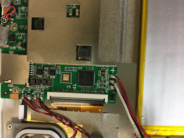

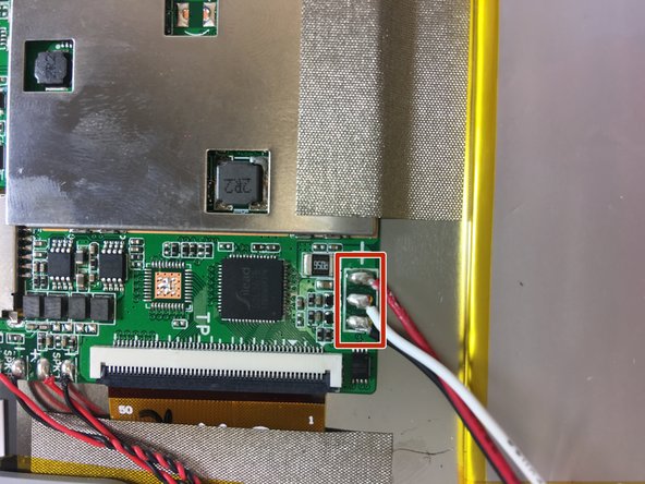

  3. Insignia Flex 10.1 NS-P16AT10 Battery Replacement: crwdns2935265:03crwdnd2935265:01crwdnd2935265:03crwdne2935265:0 Insignia Flex 10.1 NS-P16AT10 Battery Replacement: crwdns2935265:03crwdnd2935265:02crwdnd2935265:03crwdne2935265:0 Insignia Flex 10.1 NS-P16AT10 Battery Replacement: crwdns2935265:03crwdnd2935265:03crwdnd2935265:03crwdne2935265:0
    • Free the battery from the motherboard by desoldering the red, white, and black connections one by one.
    • For soldering instructions, visit this guide.
    • Remove the soldering tip immediately once the wire has become free. Too much heat can damage the motherboard.

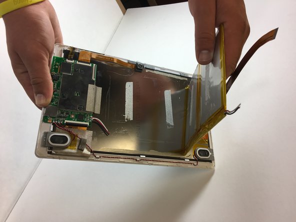

  4. Insignia Flex 10.1 NS-P16AT10 Battery Replacement: crwdns2935265:04crwdnd2935265:01crwdnd2935265:01crwdne2935265:0
    • Peel the black tape up that is attached to the battery and front case.
  5. Insignia Flex 10.1 NS-P16AT10 Battery Replacement: crwdns2935265:05crwdnd2935265:01crwdnd2935265:02crwdne2935265:0 Insignia Flex 10.1 NS-P16AT10 Battery Replacement: crwdns2935265:05crwdnd2935265:02crwdnd2935265:02crwdne2935265:0
    • Use a plastic opening tool to remove the battery from the front case.
    • Place the plastic opening tool between the battery and front case. Work the tool around the perimeter of the battery until the battery is free.
    • Do not bend or puncture the battery, or the battery will leak.
  6. Insignia Flex 10.1 NS-P16AT10 Battery Replacement: crwdns2935265:06crwdnd2935265:01crwdnd2935265:02crwdne2935265:0 Insignia Flex 10.1 NS-P16AT10 Battery Replacement: crwdns2935265:06crwdnd2935265:02crwdnd2935265:02crwdne2935265:0
    • The battery is now removed from the device. Replace the battery.
