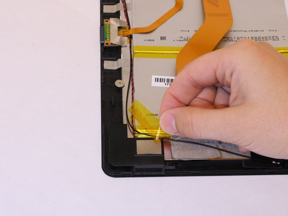

  4. Insignia Flex 10.1 NS-P10W8100 Speaker Replacement: crwdns2935265:04crwdnd2935265:01crwdnd2935265:02crwdne2935265:0 Insignia Flex 10.1 NS-P10W8100 Speaker Replacement: crwdns2935265:04crwdnd2935265:02crwdnd2935265:02crwdne2935265:0
    • Using a fingernail, gently pull back on the yellow tape holding the speaker wire in place.
    • Looking on the right side of the device remove the second piece of tape the same way.
    • Try to place the the tape in a location with little dust for later when reinstalling the tape.

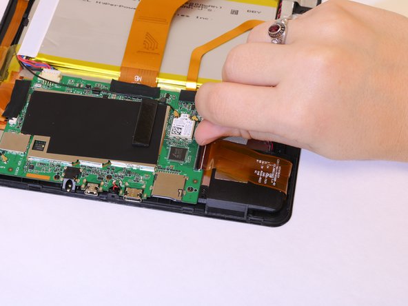

  5. Insignia Flex 10.1 NS-P10W8100 Speaker Replacement: crwdns2935265:05crwdnd2935265:01crwdnd2935265:02crwdne2935265:0 Insignia Flex 10.1 NS-P10W8100 Speaker Replacement: crwdns2935265:05crwdnd2935265:02crwdnd2935265:02crwdne2935265:0
    • Remove the black tape covering the ribbon connector.
    • Then use a fingernail to lift up the black edge on top of the ribbon connector.

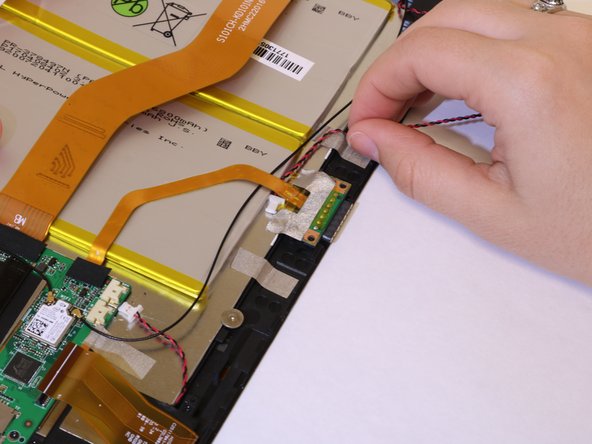

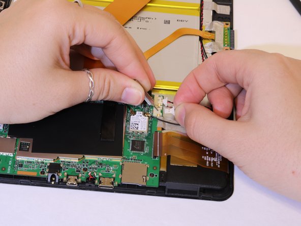

  6. Insignia Flex 10.1 NS-P10W8100 Speaker Replacement: crwdns2935265:06crwdnd2935265:01crwdnd2935265:03crwdne2935265:0 Insignia Flex 10.1 NS-P10W8100 Speaker Replacement: crwdns2935265:06crwdnd2935265:02crwdnd2935265:03crwdne2935265:0 Insignia Flex 10.1 NS-P10W8100 Speaker Replacement: crwdns2935265:06crwdnd2935265:03crwdnd2935265:03crwdne2935265:0
    • Gently pull on the speaker wire connector from the motherboard.
    • Then continue to slide the cable gently to clear it from other components.
    • The longer speaker wire has to be removed from under the smaller ribbon wire connected to the keyboard connector.
    • You may need to use the 0.8 tip tool to press down on the connector if it is not removing easily.
