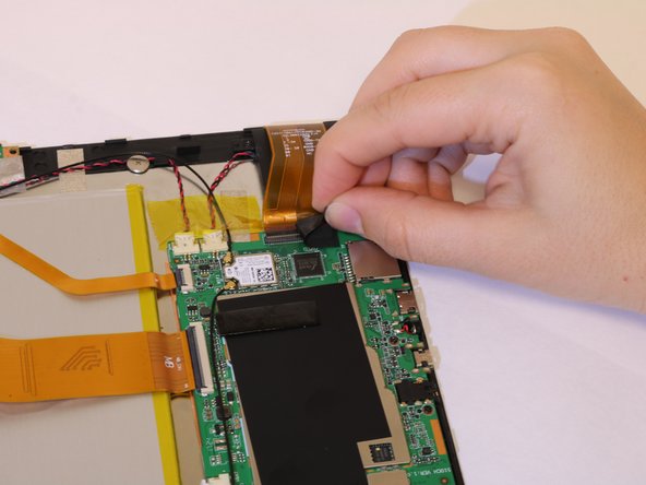

  4. Insignia Flex 10.1 NS-P10W8100 Motherboard Replacement: crwdns2935265:04crwdnd2935265:01crwdnd2935265:03crwdne2935265:0 Insignia Flex 10.1 NS-P10W8100 Motherboard Replacement: crwdns2935265:04crwdnd2935265:02crwdnd2935265:03crwdne2935265:0 Insignia Flex 10.1 NS-P10W8100 Motherboard Replacement: crwdns2935265:04crwdnd2935265:03crwdnd2935265:03crwdne2935265:0

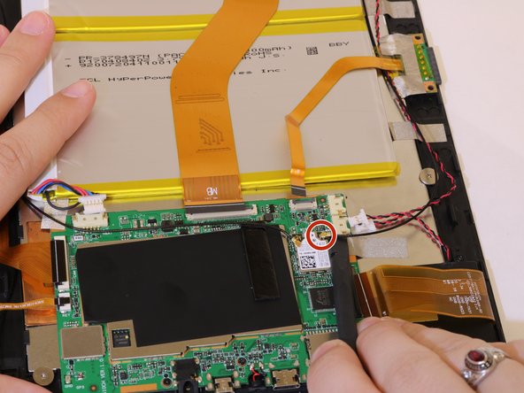

    • Gently remove the black tape from each of the three connectors.
    • It may help to move around the motherboard in a clockwise direction to remove each piece of tape.

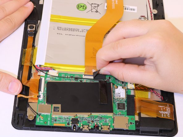

  5. Insignia Flex 10.1 NS-P10W8100 Motherboard Replacement: crwdns2935265:05crwdnd2935265:01crwdnd2935265:01crwdne2935265:0
    • With a fingernail, gently remove the yellow tape from across the speaker wires.

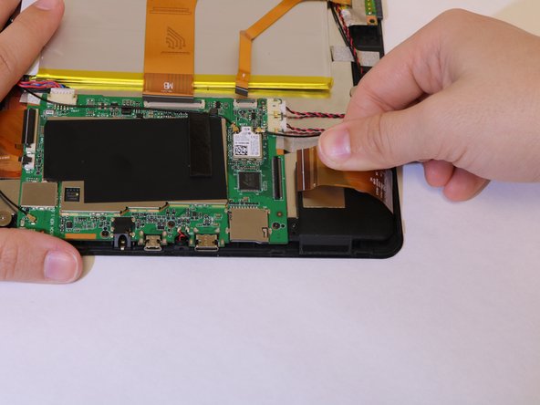

  8. Insignia Flex 10.1 NS-P10W8100 Motherboard Replacement: crwdns2935265:08crwdnd2935265:01crwdnd2935265:02crwdne2935265:0 Insignia Flex 10.1 NS-P10W8100 Motherboard Replacement: crwdns2935265:08crwdnd2935265:02crwdnd2935265:02crwdne2935265:0

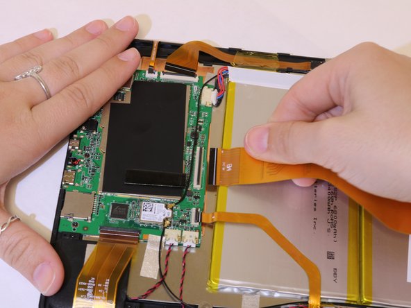

    • Following a clockwise direction, continue unplugging the ZIF connectors by safely puling the cable out.

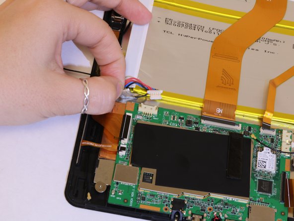

    • Remove the ribbon cables by firstly disconnecting the cable located on the top right of the motherboard,
    • Be careful not to forcefully yank the cable as it could cause a wire to disconnect.

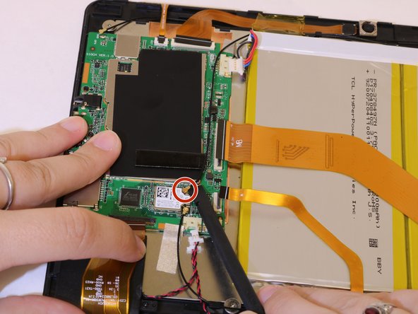

    • Disconnect the three low profile connectors by using a spudger to prop up both sides. Then, lift the connectors straight up from their sockets.

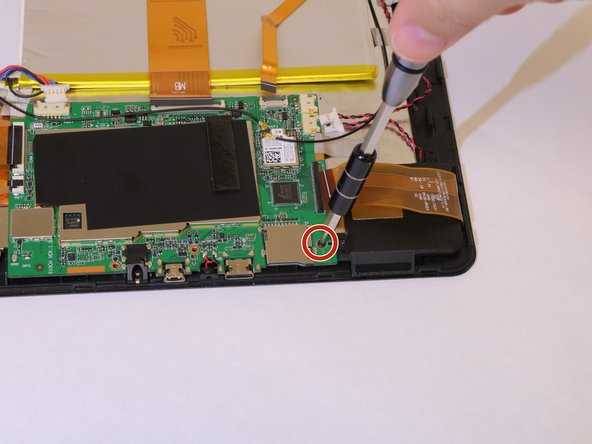

  12. Insignia Flex 10.1 NS-P10W8100 Motherboard Replacement: crwdns2935265:012crwdnd2935265:01crwdnd2935265:03crwdne2935265:0 Insignia Flex 10.1 NS-P10W8100 Motherboard Replacement: crwdns2935265:012crwdnd2935265:02crwdnd2935265:03crwdne2935265:0 Insignia Flex 10.1 NS-P10W8100 Motherboard Replacement: crwdns2935265:012crwdnd2935265:03crwdnd2935265:03crwdne2935265:0

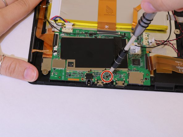

    • Using a Phillips #2 screwdriver, remove the three 4 mm screws to free the motherboard.

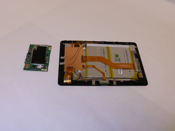

  14. Insignia Flex 10.1 NS-P10W8100 Motherboard Replacement: crwdns2935265:014crwdnd2935265:01crwdnd2935265:02crwdne2935265:0 Insignia Flex 10.1 NS-P10W8100 Motherboard Replacement: crwdns2935265:014crwdnd2935265:02crwdnd2935265:02crwdne2935265:0
    • Remove the motherboard by lifting it upward.
