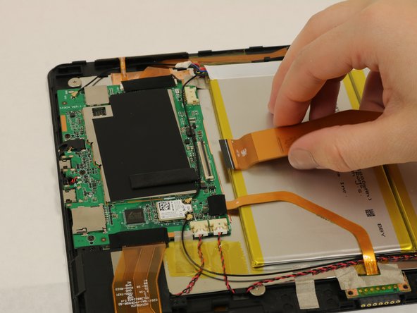

  4. Insignia Flex 10.1 NS-P10W8100 Battery Replacement: crwdns2935265:04crwdnd2935265:01crwdnd2935265:02crwdne2935265:0 Insignia Flex 10.1 NS-P10W8100 Battery Replacement: crwdns2935265:04crwdnd2935265:02crwdnd2935265:02crwdne2935265:0
    • Unplug the power supply by disconnecting the red and blue wires found on the motherboard.
  5. Insignia Flex 10.1 NS-P10W8100 Battery Replacement: crwdns2935265:05crwdnd2935265:01crwdnd2935265:01crwdne2935265:0
    • Remove the black tape from the Zero Insertion Force (ZIF) ribbon connector.
  6. Insignia Flex 10.1 NS-P10W8100 Battery Replacement: crwdns2935265:06crwdnd2935265:01crwdnd2935265:02crwdne2935265:0 Insignia Flex 10.1 NS-P10W8100 Battery Replacement: crwdns2935265:06crwdnd2935265:02crwdnd2935265:02crwdne2935265:0
    • Lift up on the black locking flap, being careful not to damage the surrounding hardware parts.
    • Remove the ZIF ribbon wire by pulling horizontally towards the battery.

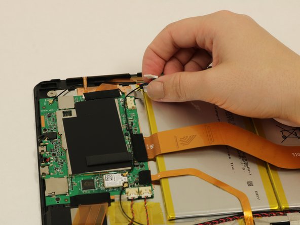

  7. Insignia Flex 10.1 NS-P10W8100 Battery Replacement: crwdns2935265:07crwdnd2935265:01crwdnd2935265:01crwdne2935265:0
    • Remove the black tape from the small ribbon wire connector.
    • Pull the ribbon connector out of the plug the same way that was mentioned in step 4.
  8. Insignia Flex 10.1 NS-P10W8100 Battery Replacement: crwdns2935265:08crwdnd2935265:01crwdnd2935265:01crwdne2935265:0
    • Use the spudger to separate the battery from the base.
    • The battery can be difficult to remove as it is held in with double sided tape.
    • Be sure not to pry on the battery too hard because damage to the screen and/or the battery can occur.
