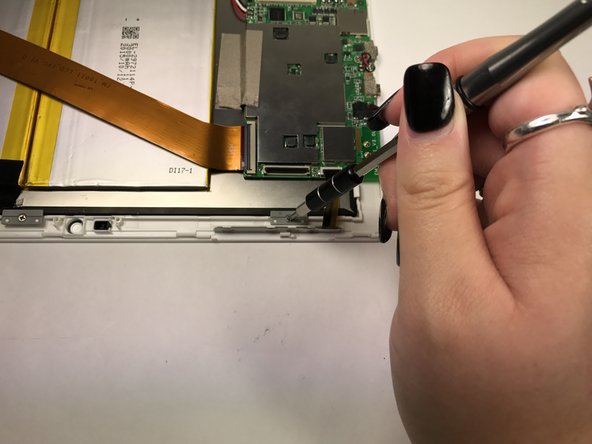

    • Using the Phillips #000 screw driver, unscrew the four 4 mm screws securing the four gray clasps to the front panel in a counterclockwise direction.
    • The four screws are very small, so be careful not to lose them after unscrewing them.

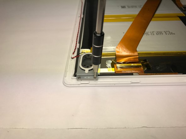

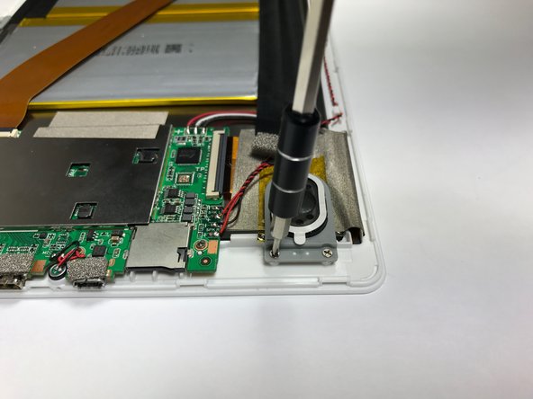

    • Using the Phillips #000 screw driver, unscrew the four 4 mm screws securing the speakers to the front panel in a counterclockwise direction.

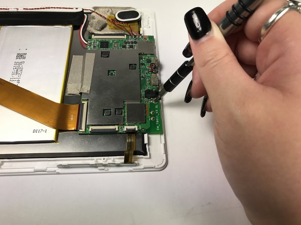

    • Using the Phillips #000 screw driver, unscrew the three 4 mm screws securing the motherboard to the front panel in a counterclockwise direction.
    • The three screws are very small, so be careful not to lose them after unscrewing them.

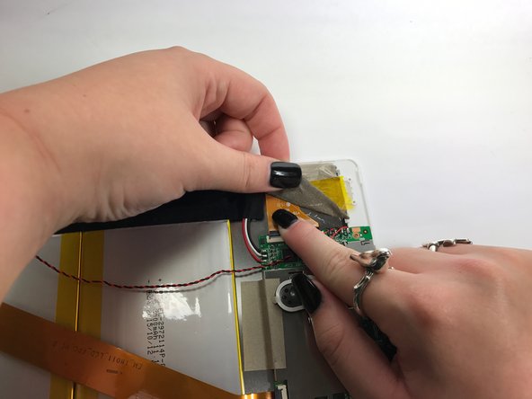

    • Using the plastic opening tool, remove the silver tape covering the display ZIF (zero insertion force) ribbon connector.
  14. Insignia Flex 10.1 NS-P10A6100 Screen Replacement: crwdns2935265:014crwdnd2935265:01crwdnd2935265:01crwdne2935265:0
    • Using the plastic opening tool, lift up the black retaining flap that secures the display ZIF (zero insertion force) ribbon connector to the motherboard.
