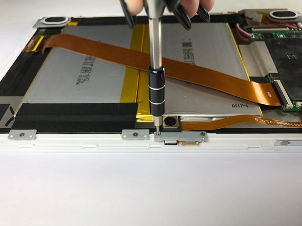

  4. Insignia Flex 10.1 NS-P10A6100 Camera Replacement, Camera: crwdns2935265:04crwdnd2935265:01crwdnd2935265:02crwdne2935265:0 Insignia Flex 10.1 NS-P10A6100 Camera Replacement, Camera: crwdns2935265:04crwdnd2935265:02crwdnd2935265:02crwdne2935265:0
    • Using the Phillips #000 screw driver, unscrew the two 4 mm screws securing the camera to the front panel in a counterclockwise direction.
    • The two screws are very small, so be careful not to lose them after unscrewing them.
