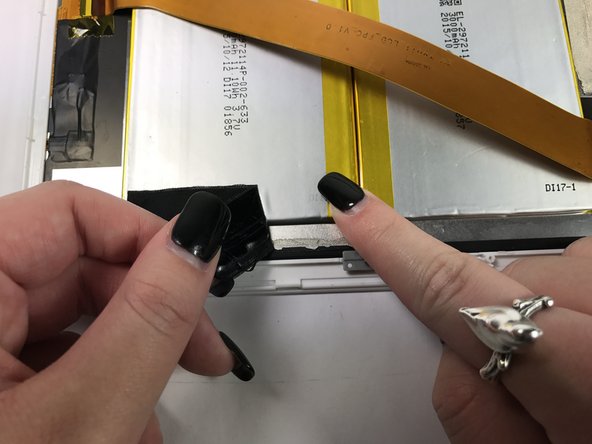

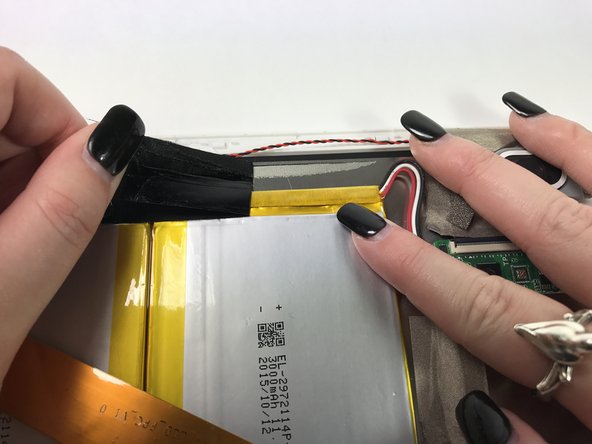

  6. Insignia Flex 10.1 NS-P10A6100 Battery Replacement: crwdns2935265:06crwdnd2935265:01crwdnd2935265:03crwdne2935265:0 Insignia Flex 10.1 NS-P10A6100 Battery Replacement: crwdns2935265:06crwdnd2935265:02crwdnd2935265:03crwdne2935265:0 Insignia Flex 10.1 NS-P10A6100 Battery Replacement: crwdns2935265:06crwdnd2935265:03crwdnd2935265:03crwdne2935265:0
    • Using the plastic opening tool, remove the black tape that secures the battery to the front panel.
    • Repeat this process for the black tape securing the other side of the battery to the front panel.
