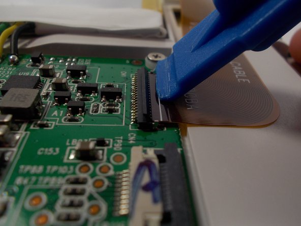

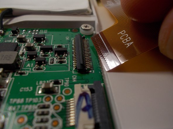

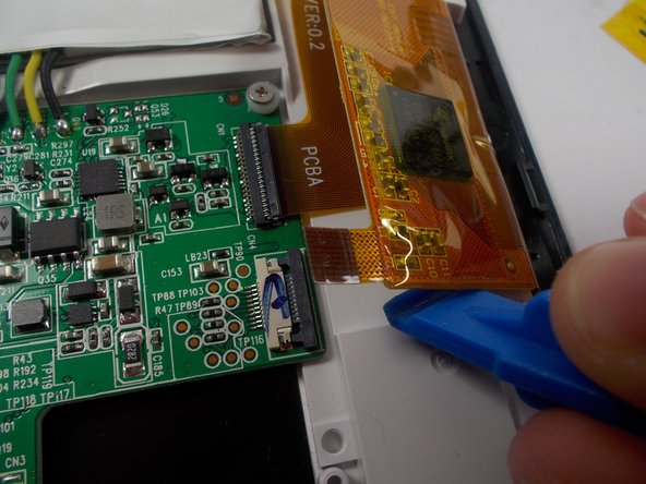

  6. Insignia Flex 10.1 Motherboard Replacement: crwdns2935265:06crwdnd2935265:01crwdnd2935265:01crwdne2935265:0
    • Peel off the tape covering the two connections labeled in orange.
  7. Insignia Flex 10.1 Motherboard Replacement: crwdns2935265:07crwdnd2935265:01crwdnd2935265:03crwdne2935265:0 Insignia Flex 10.1 Motherboard Replacement: crwdns2935265:07crwdnd2935265:02crwdnd2935265:03crwdne2935265:0 Insignia Flex 10.1 Motherboard Replacement: crwdns2935265:07crwdnd2935265:03crwdnd2935265:03crwdne2935265:0
    • Remove the ribbon cable by lifting up on the connection with a plastic opening tool and pulling out the ribbon cable.

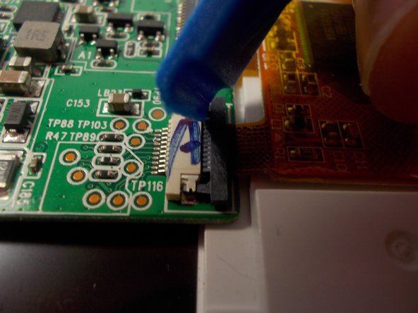

  8. Insignia Flex 10.1 Motherboard Replacement: crwdns2935265:08crwdnd2935265:01crwdnd2935265:03crwdne2935265:0 Insignia Flex 10.1 Motherboard Replacement: crwdns2935265:08crwdnd2935265:02crwdnd2935265:03crwdne2935265:0 Insignia Flex 10.1 Motherboard Replacement: crwdns2935265:08crwdnd2935265:03crwdnd2935265:03crwdne2935265:0

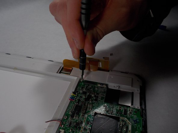

  10. Insignia Flex 10.1 Motherboard Replacement: crwdns2935265:010crwdnd2935265:01crwdnd2935265:02crwdne2935265:0 Insignia Flex 10.1 Motherboard Replacement: crwdns2935265:010crwdnd2935265:02crwdnd2935265:02crwdne2935265:0
    • Use a Phillips head #0 screwdriver to unscrew the 5 philips head screws labeled in BLUE.

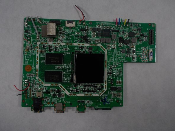

  12. Insignia Flex 10.1 Motherboard Replacement: crwdns2935265:012crwdnd2935265:01crwdnd2935265:01crwdne2935265:0
    • The motherboard is now free and should look like this.
