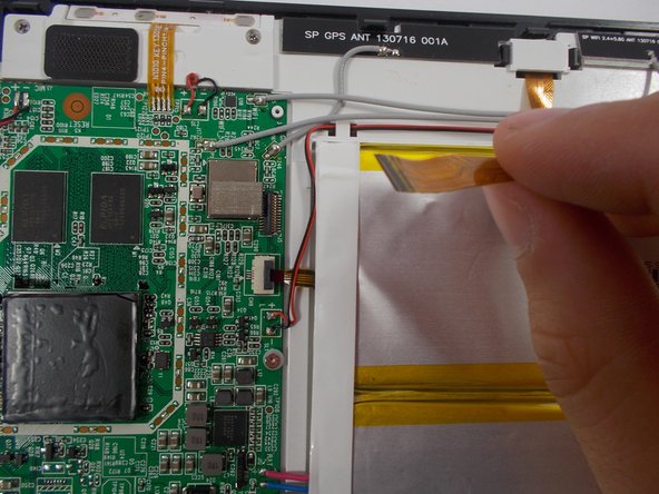

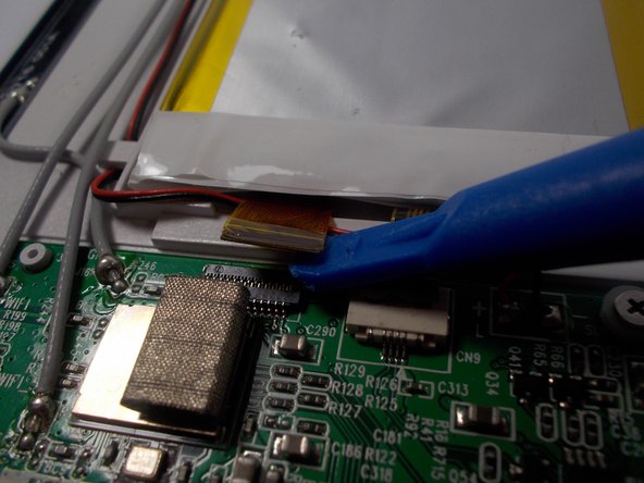

  6. Insignia Flex 10.1 Battery Replacement: crwdns2935265:06crwdnd2935265:01crwdnd2935265:03crwdne2935265:0 Insignia Flex 10.1 Battery Replacement: crwdns2935265:06crwdnd2935265:02crwdnd2935265:03crwdne2935265:0 Insignia Flex 10.1 Battery Replacement: crwdns2935265:06crwdnd2935265:03crwdnd2935265:03crwdne2935265:0
    • Disconnect the ribbon cable from the motherboard by lifting up on the connector.

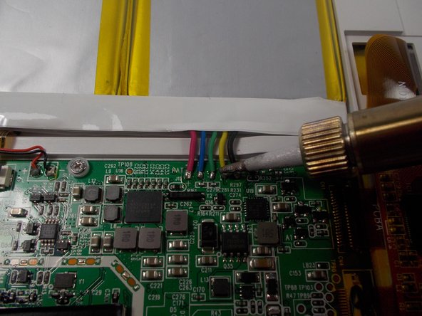

  7. Insignia Flex 10.1 Battery Replacement: crwdns2935265:07crwdnd2935265:01crwdnd2935265:02crwdne2935265:0 Insignia Flex 10.1 Battery Replacement: crwdns2935265:07crwdnd2935265:02crwdnd2935265:02crwdne2935265:0
    • The battery is connected to the motherboard by 5 wires soldered to the motherboard.
    • Those who are new to soldering may want to check out iFixit's soldering technique guide. How To Solder and Desolder Connections.
    • Begin by heating up the five solder joints on the motherboard one at a time.
    • When the solder melts and the wire is free from the motherboard, immediately lift the solder tip off the connection to avoid damage.
    • Due to the fragile nature of electronic components, it is important to limit the amount of heat transferred from the soldering iron to the motherboard. A simple way to accomplish this is to pull the wires with gentle continuous tension while the soldering iron heats up the connection.

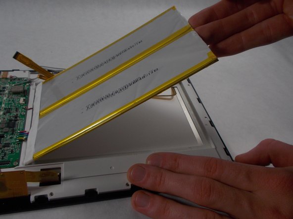

  8. Insignia Flex 10.1 Battery Replacement: crwdns2935265:08crwdnd2935265:01crwdnd2935265:02crwdne2935265:0 Insignia Flex 10.1 Battery Replacement: crwdns2935265:08crwdnd2935265:02crwdnd2935265:02crwdne2935265:0
    • The battery is glued in place.
    • Insert the plastic opening tool along the edge of the battery and gently pry out the battery.
    • Don't be afraid to apply some extra force when lifting the battery. An optional step is to heat up the glue with a blow dryer to soften the glue so the battery is easier to remove.
  9. Insignia Flex 10.1 Battery Replacement: crwdns2935265:09crwdnd2935265:01crwdnd2935265:01crwdne2935265:0
    • The battery is now removed and can be replaced.
