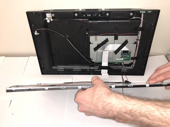

  3. Insignia 24" LED Roku TV Screen Replacement, Pry the TV open: crwdns2935265:03crwdnd2935265:01crwdnd2935265:01crwdne2935265:0
    • Stand the TV on its top edge.
    • Gently pry apart the front and back of the TV.
    • The two halves should pull apart easily since there are no longer any screws holding it together.
    • The two halves will still be connected by wires and cables that are taped to each side. Do not pull on these. We will remove them in the next step.

    • Spread apart your TV the rest of the way, but do not disconnect any of the wires.
    • You should have a clear view of the inside on both sides.

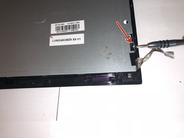

  7. Insignia 24" LED Roku TV Screen Replacement: crwdns2935265:07crwdnd2935265:01crwdnd2935265:02crwdne2935265:0 Insignia 24" LED Roku TV Screen Replacement: crwdns2935265:07crwdnd2935265:02crwdnd2935265:02crwdne2935265:0
    • Using the Phillips 00 Screwdriver, remove the screws that are also holding the silver rectangular piece to the house.

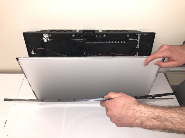

  8. Insignia 24" LED Roku TV Screen Replacement: crwdns2935265:08crwdnd2935265:01crwdnd2935265:03crwdne2935265:0 Insignia 24" LED Roku TV Screen Replacement: crwdns2935265:08crwdnd2935265:02crwdnd2935265:03crwdne2935265:0 Insignia 24" LED Roku TV Screen Replacement: crwdns2935265:08crwdnd2935265:03crwdnd2935265:03crwdne2935265:0
    • Remove the plastic casing from the glass screen.
    • Then carefully remove metal backing from glass screen and separate the layer of plastic from the glass screen.

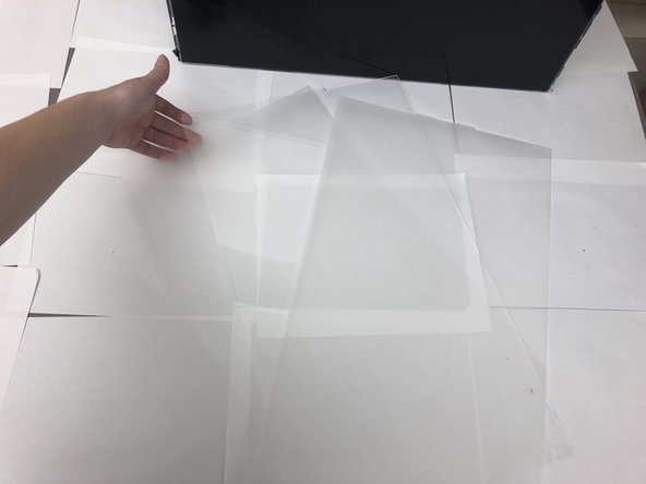

  9. Insignia 24" LED Roku TV Screen Replacement: crwdns2935265:09crwdnd2935265:01crwdnd2935265:02crwdne2935265:0 Insignia 24" LED Roku TV Screen Replacement: crwdns2935265:09crwdnd2935265:02crwdnd2935265:02crwdne2935265:0
    • Separate plastic screen protector layers from both the backing and glass screen.
    • The second picture provides image of what the plastic screen protectors look like.

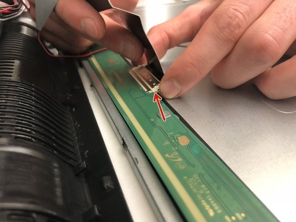

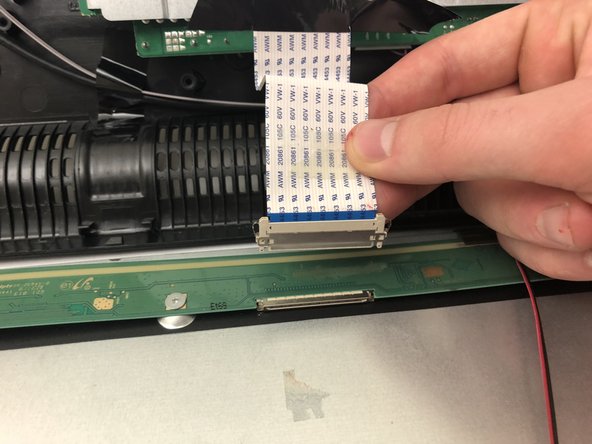

    • Find the display board and unplug the white ribbon cord from the board.
    • Squeeze both sides of the plug to release the cord.

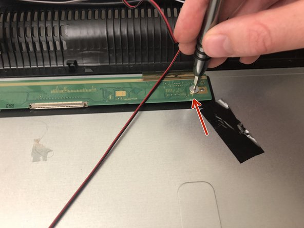

  11. Insignia 24" LED Roku TV Screen Replacement: crwdns2935265:011crwdnd2935265:01crwdnd2935265:03crwdne2935265:0 Insignia 24" LED Roku TV Screen Replacement: crwdns2935265:011crwdnd2935265:02crwdnd2935265:03crwdne2935265:0 Insignia 24" LED Roku TV Screen Replacement: crwdns2935265:011crwdnd2935265:03crwdnd2935265:03crwdne2935265:0
    • Using same screwdriver, unscrew the screws that are on the green display board.
    • Separate the green display board from its metal backing.

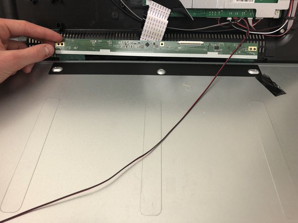

  12. Insignia 24" LED Roku TV Screen Replacement: crwdns2935265:012crwdnd2935265:01crwdnd2935265:01crwdne2935265:0
    • All cables connecting screen to frame are now detached.
    • Now pull apart and separate the screen.
To reassemble your TV, follow these instructions in reverse order.
