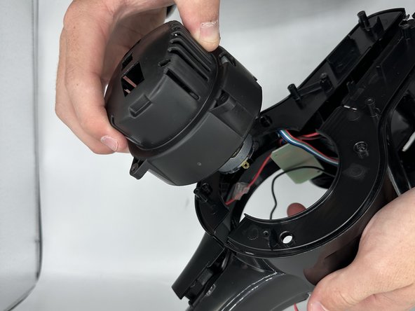

Inse N500 Motor Replacement
    1. Inse N500 Motor Replacement, Dustbin: crwdns2935265:01crwdnd2935265:01crwdnd2935265:03crwdne2935265:0 Inse N500 Motor Replacement, Dustbin: crwdns2935265:01crwdnd2935265:02crwdnd2935265:03crwdne2935265:0 Inse N500 Motor Replacement, Dustbin: crwdns2935265:01crwdnd2935265:03crwdnd2935265:03crwdne2935265:0
      • Unclip the plastic band from the vacuum head.
    2. Inse N500 Motor Replacement: crwdns2935265:02crwdnd2935265:01crwdnd2935265:02crwdne2935265:0 Inse N500 Motor Replacement: crwdns2935265:02crwdnd2935265:02crwdnd2935265:02crwdne2935265:0
      • Remove six 6 mm screws using a Phillips #0 screwdriver.
    3. Inse N500 Motor Replacement: crwdns2935265:03crwdnd2935265:01crwdnd2935265:02crwdne2935265:0 Inse N500 Motor Replacement: crwdns2935265:03crwdnd2935265:02crwdnd2935265:02crwdne2935265:0
      • Remove the vacuum head guard.
    4. Inse N500 Motor Replacement: crwdns2935265:04crwdnd2935265:01crwdnd2935265:02crwdne2935265:0 Inse N500 Motor Replacement: crwdns2935265:04crwdnd2935265:02crwdnd2935265:02crwdne2935265:0
      • Remove the ten 4 mm screws using a Phillips #0 screwdriver.
      • There are five screws on each side of the vacuum.
    5. Inse N500 Motor Replacement: crwdns2935265:05crwdnd2935265:01crwdnd2935265:02crwdne2935265:0 Inse N500 Motor Replacement: crwdns2935265:05crwdnd2935265:02crwdnd2935265:02crwdne2935265:0
      • Remove the single 4 mm screw from the circuit board using a Phillips #0 screwdriver.
    6. Inse N500 Motor Replacement: crwdns2935265:06crwdnd2935265:01crwdnd2935265:02crwdne2935265:0 Inse N500 Motor Replacement: crwdns2935265:06crwdnd2935265:02crwdnd2935265:02crwdne2935265:0
      • Unfasten the remaining clips.
    7. Inse N500 Motor Replacement: crwdns2935265:07crwdnd2935265:01crwdnd2935265:03crwdne2935265:0 Inse N500 Motor Replacement: crwdns2935265:07crwdnd2935265:02crwdnd2935265:03crwdne2935265:0 Inse N500 Motor Replacement: crwdns2935265:07crwdnd2935265:03crwdnd2935265:03crwdne2935265:0
      • Remove the dustbin.
    1. Inse N500 Motor Replacement, Motor: crwdns2935265:08crwdnd2935265:01crwdnd2935265:02crwdne2935265:0 Inse N500 Motor Replacement, Motor: crwdns2935265:08crwdnd2935265:02crwdnd2935265:02crwdne2935265:0
      • Unfasten the surrounding motor clips and remove the motor.
