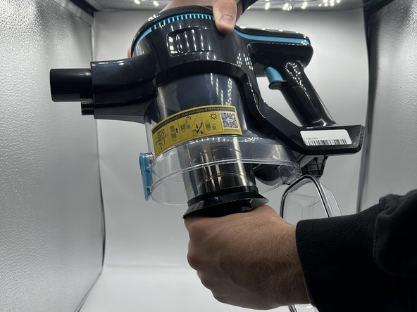

    • Press the blue release button to separate the main motor unit from the rest of the vacuum cleaner.
  2. Inse N500 Filter Replacement: crwdns2935265:02crwdnd2935265:01crwdnd2935265:03crwdne2935265:0 Inse N500 Filter Replacement: crwdns2935265:02crwdnd2935265:02crwdnd2935265:03crwdne2935265:0 Inse N500 Filter Replacement: crwdns2935265:02crwdnd2935265:03crwdnd2935265:03crwdne2935265:0
    • Press the blue release button to access the internal components of the dustbin.

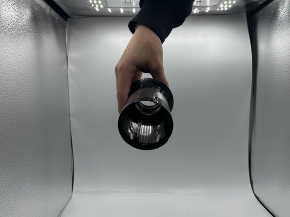

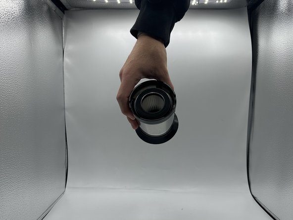

    • Remove the vacuum's filter enclosure/strainer.
  4. Inse N500 Filter Replacement: crwdns2935265:04crwdnd2935265:01crwdnd2935265:02crwdne2935265:0 Inse N500 Filter Replacement: crwdns2935265:04crwdnd2935265:02crwdnd2935265:02crwdne2935265:0
    • Remove the filter.
