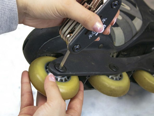

    • Locate the axel at the center of the wheel.
  2. Inline Skates Wheels and Bearings Replacement: crwdns2935265:02crwdnd2935265:01crwdnd2935265:02crwdne2935265:0 Inline Skates Wheels and Bearings Replacement: crwdns2935265:02crwdnd2935265:02crwdnd2935265:02crwdne2935265:0
    • Using an Allen Wrench, place the end of the wrench in the axle in the center of the axle and twist counterclockwise until loose.
  3. Inline Skates Wheels and Bearings Replacement: crwdns2935265:03crwdnd2935265:01crwdnd2935265:02crwdne2935265:0 Inline Skates Wheels and Bearings Replacement: crwdns2935265:03crwdnd2935265:02crwdnd2935265:02crwdne2935265:0
    • Once the axel is loosened, proceed to slide the wheel along with its axel out of position.
  4. Inline Skates Wheels and Bearings Replacement: crwdns2935265:04crwdnd2935265:01crwdnd2935265:01crwdne2935265:0
    • Remove the damaged wheel.
  5. Inline Skates Wheels and Bearings Replacement: crwdns2935265:05crwdnd2935265:01crwdnd2935265:01crwdne2935265:0
    • Take this opportunity to clean the frame of the rollerblade.
  6. Inline Skates Wheels and Bearings Replacement: crwdns2935265:06crwdnd2935265:01crwdnd2935265:01crwdne2935265:0
    • Gently wedge the Allen Wrench into the bearing and using an upward force at a 35-45 degree angle, carefully slide/pop out the bearing.
    • To reduce the chance of injuring yourself, wedge the bearing away from you
  7. Inline Skates Wheels and Bearings Replacement: crwdns2935265:07crwdnd2935265:01crwdnd2935265:01crwdne2935265:0
    • Once the bearing is successfully removed, slide the spacer out.
  8. Inline Skates Wheels and Bearings Replacement: crwdns2935265:08crwdnd2935265:01crwdnd2935265:01crwdne2935265:0
    • Then proceed to flip the wheel on its opposite side and use the Allen Wrench again to push out the remaining bearing from the wheel.
  9. Inline Skates Wheels and Bearings Replacement: crwdns2935265:09crwdnd2935265:01crwdnd2935265:01crwdne2935265:0
    • Take the new wheel replacement and fit a bearing, place the spacer in the center and place the other bearing on the other side.
  10. Inline Skates Wheels and Bearings Replacement: crwdns2935265:010crwdnd2935265:01crwdnd2935265:02crwdne2935265:0 Inline Skates Wheels and Bearings Replacement: crwdns2935265:010crwdnd2935265:02crwdnd2935265:02crwdne2935265:0
    • Take the new wheel replacement, and align it with the frame so that the bearings and axle hole align.
    • Proceed to slide the axle through the hole of the frame and bearings and loosely tighten by hand turning clockwise to ensure proper alignment.
  11. Inline Skates Wheels and Bearings Replacement: crwdns2935265:011crwdnd2935265:01crwdnd2935265:02crwdne2935265:0 Inline Skates Wheels and Bearings Replacement: crwdns2935265:011crwdnd2935265:02crwdnd2935265:02crwdne2935265:0
    • Then proceed to place the end of the wrench in the axle in the center of the wheel and twist clockwise until resistance is felt.
To reassemble your device, follow the instructions in reverse order.
