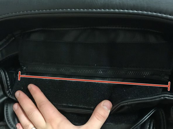

      • Unzip the following zipper at the very top of the chair. It is hidden beneath Velcro .
      • Leave back pad like this no need to unzip any other zippers.

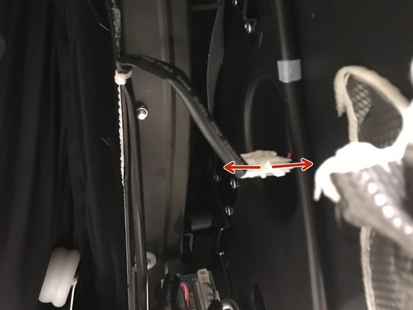

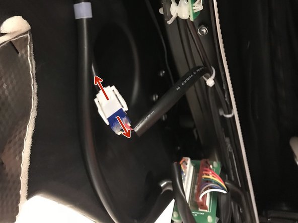

      • You will need to disconnect the power cables on Left and Ride side of the hood assembly . They are attached via a clip. Simply push the clip down and pull them apart.

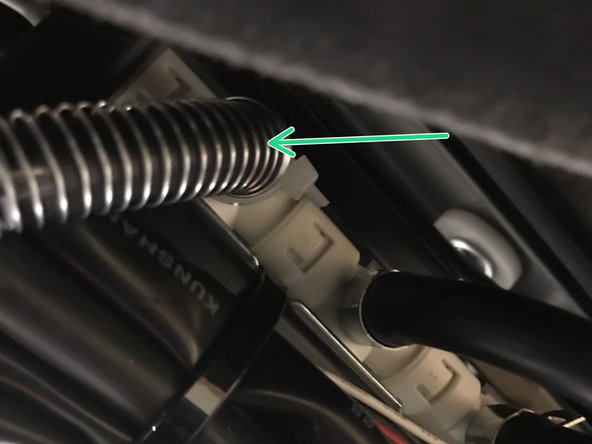

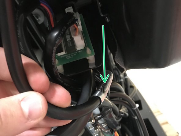

      • You need to find the 6 way air valve on the left and right hand side.
      • You then need to Locate and remove the top air hose from the valve. You can usually identify this hose by the armor cover it has on it . Additionally its the only air hose that goes to the top.

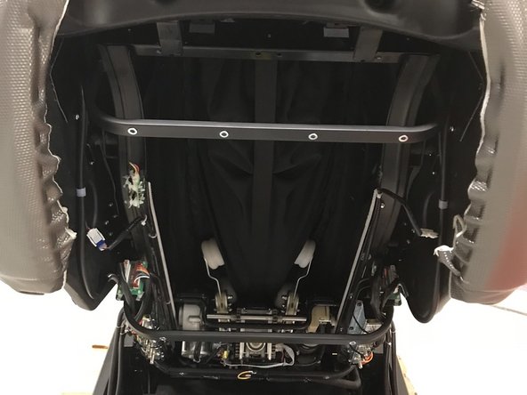

      • BEFORE CONTINUING DOUBLE CHECK YOU HAVE DONE THE PREVIOUS STEPS TO ENSURE EVERYTHING HAS BEEN DISCONNECTED .

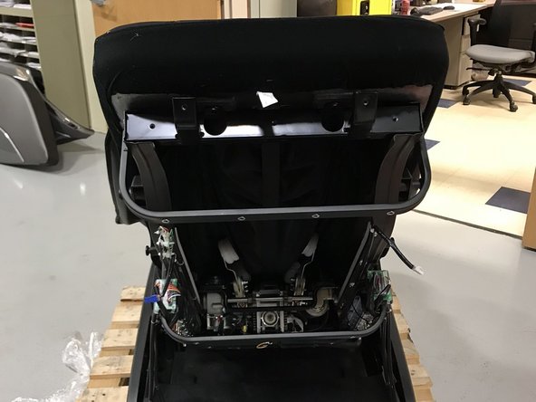

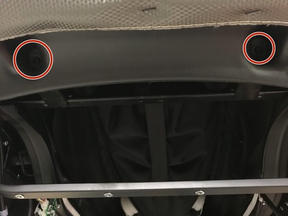

      • To remove the hood piece lift upwards to slide it off of the Frame points.
      • Marked here are the 4 frame points . Remember where these are for re- assembly.
      • See last photo for end result.

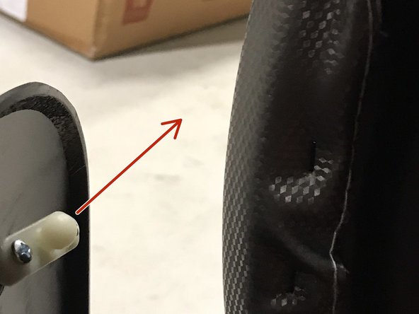

      • For reassembly of back panel Please be sure to lock in these Ball and Joint pieces into each other . They are located at the top of the chair.
      • If you don't lock these in first you will have a harder time securing this panel back on . Additionally once these Ball and joint pieces are connected. Secure the middle screws on the cover first this will ensure the cover will line up with the other bolts.
