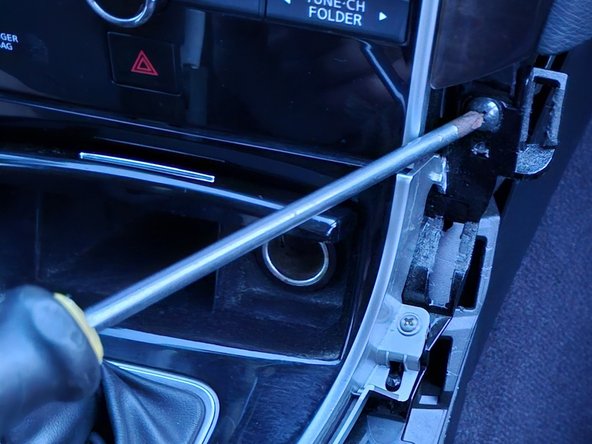

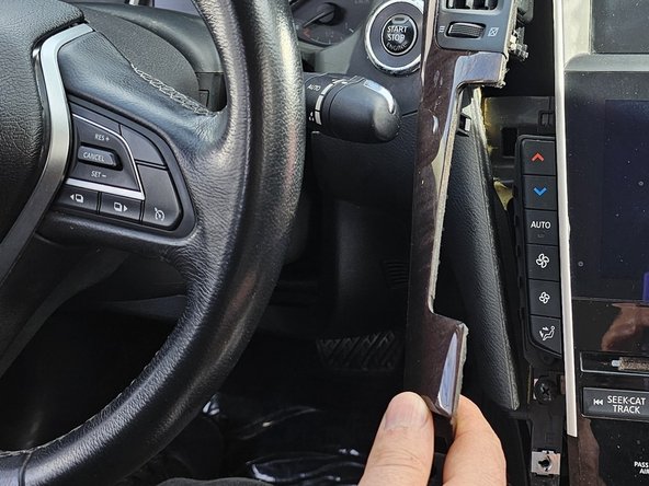

    • Use a panel popper or screwdriver to pop out the side panels of the center console.

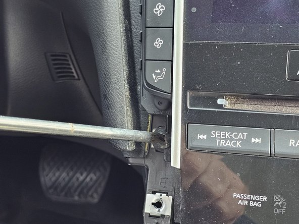

    • Remove the two screws found underneath the side panels.

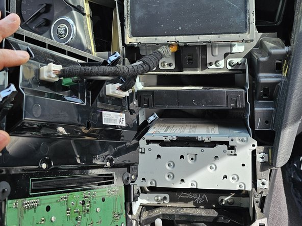

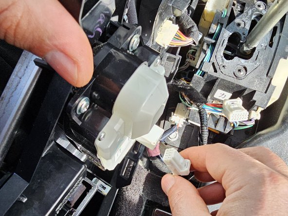

  7. Infiniti Q50 Bottom Screen Display Replacement: crwdns2935265:07crwdnd2935265:01crwdnd2935265:02crwdne2935265:0 Infiniti Q50 Bottom Screen Display Replacement: crwdns2935265:07crwdnd2935265:02crwdnd2935265:02crwdne2935265:0
    • Pinch the tip of each connector cord to detach from the center console.

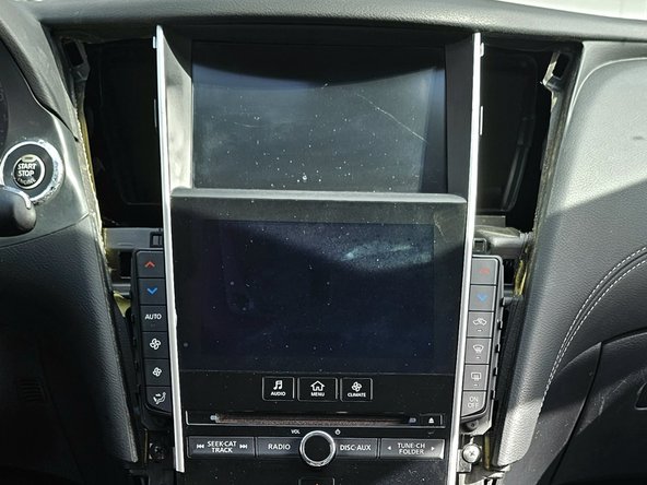

  8. Infiniti Q50 Bottom Screen Display Replacement: crwdns2935265:08crwdnd2935265:01crwdnd2935265:03crwdne2935265:0 Infiniti Q50 Bottom Screen Display Replacement: crwdns2935265:08crwdnd2935265:02crwdnd2935265:03crwdne2935265:0 Infiniti Q50 Bottom Screen Display Replacement: crwdns2935265:08crwdnd2935265:03crwdnd2935265:03crwdne2935265:0
    • Pull off the trim found on either side of the display screen.
  9. Infiniti Q50 Bottom Screen Display Replacement: crwdns2935265:09crwdnd2935265:01crwdnd2935265:02crwdne2935265:0 Infiniti Q50 Bottom Screen Display Replacement: crwdns2935265:09crwdnd2935265:02crwdnd2935265:02crwdne2935265:0
    • Remove the two screws underneath the trim.
  10. Infiniti Q50 Bottom Screen Display Replacement: crwdns2935265:010crwdnd2935265:01crwdnd2935265:02crwdne2935265:0 Infiniti Q50 Bottom Screen Display Replacement: crwdns2935265:010crwdnd2935265:02crwdnd2935265:02crwdne2935265:0
    • Wiggle to pull out the bottom screen display.

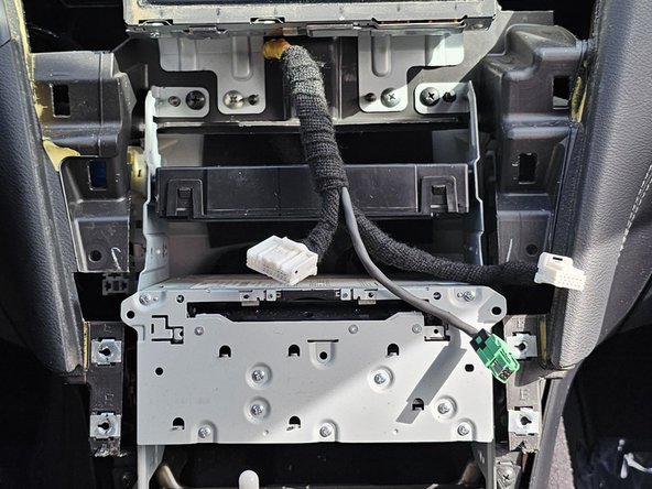

  11. Infiniti Q50 Bottom Screen Display Replacement: crwdns2935265:011crwdnd2935265:01crwdnd2935265:02crwdne2935265:0 Infiniti Q50 Bottom Screen Display Replacement: crwdns2935265:011crwdnd2935265:02crwdnd2935265:02crwdne2935265:0
    • Pinch to detach the connector cords.
