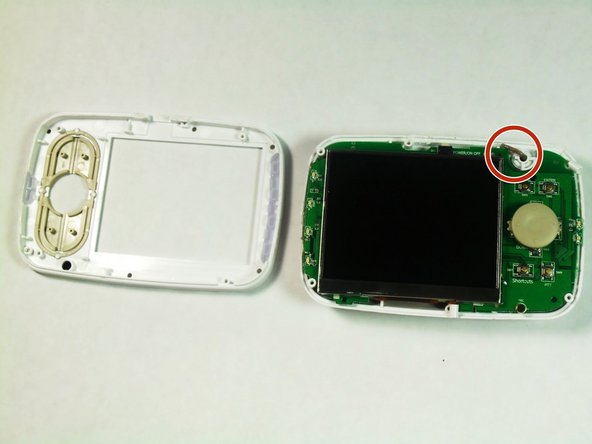

    • Start by gently inserting the plastic opening tool between the led and casing.
  2. Infant Optics DXR-8 Monitor Replacement: crwdns2935265:02crwdnd2935265:01crwdnd2935265:01crwdne2935265:0
    • Slowly pry the cover away from the bottom using the plastic opening tool.
  3. Infant Optics DXR-8 Monitor Replacement: crwdns2935265:03crwdnd2935265:01crwdnd2935265:01crwdne2935265:0
    • Glide the tool around the entire cover to reveal the screws, which are 5.0 mm.
  4. Infant Optics DXR-8 Monitor Replacement: crwdns2935265:04crwdnd2935265:01crwdnd2935265:01crwdne2935265:0
    • Remove the cover and set it aside.
  5. Infant Optics DXR-8 Monitor Replacement: crwdns2935265:05crwdnd2935265:01crwdnd2935265:02crwdne2935265:0 Infant Optics DXR-8 Monitor Replacement: crwdns2935265:05crwdnd2935265:02crwdnd2935265:02crwdne2935265:0
    • Remove the four corner screws, 5.0 mm, using a J1 bit.
    • Lift the top away from the bottom using the metal spudger. Be careful not to rip the antenna wire.

What is the part number for the LCD?
jstarion - crwdns2934203:0crwdne2934203:0
From the pictures LQ035NC111 seem to be the part number.
